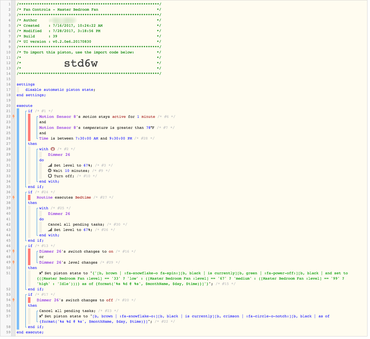

I recently got a GE Zwave plus fan controller for the bedroom fan and am now brainstorming how to automate it. I have played with the virtual thermostat and 3 speed ceiling fan thermostat smart apps, but don’t love them yet. I was wondering what people have done on Webcore.
I don’t necessarily want the fan on in the room when I’m not there but don’t have a motion sensor only a door sensor and I prefer to manually turn it on but then automate when it turns off. My wife doesn’t like the fan on. I’m hoping I could use an already created piston and then tweak it to my needs.

Simple piston that turns on during the day if movement and on with Bedtime routine. Turning off in the morning is handled outside of this piston for now. Also reports piston state. I have variations of this for fans all over the house.

I guess I am looking for only an auto off feature. My wife doesn’t like the fan higher than low. I don’t the auto speed change. I can manually do that. (when she isn’t home) I could put in some presence logic, but don’t need to complicate things.
The other smart apps I have tried will turn on the fan automatically and I want to control that manually.
If fan is on and temp drops below 72
