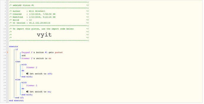

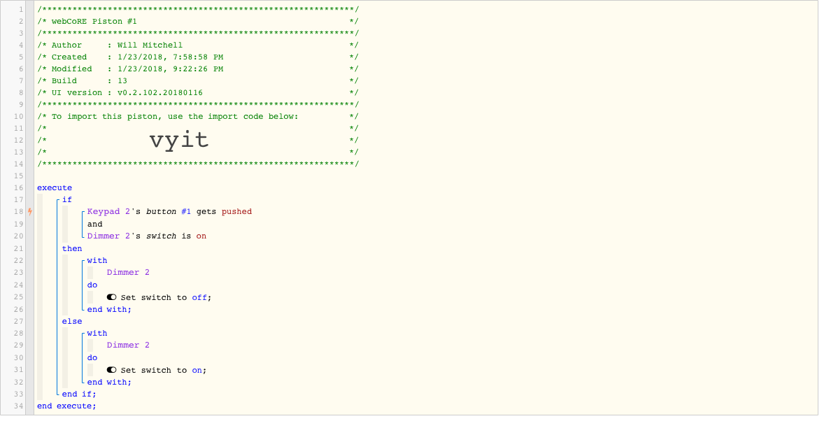

Hello!!! So I’ve been working on this for the past 10 hours and cannot figure it out.
I have a button that I want to turn on a light. If the light is on, I want it to turn off. After I get that working, I want long press to turn on the light at 100% and then fade down until the press is released. Whenever I implement this first part, simple turning on and off, I get various results. Sometimes the light turns on perfectly, but won’t turn off. Sometimes the other way around. Always though, it seems to be looping, where it will turn on and off the light.
Please help, I want to like this platform, but I’m finding this simple task very challenging. Thank you!

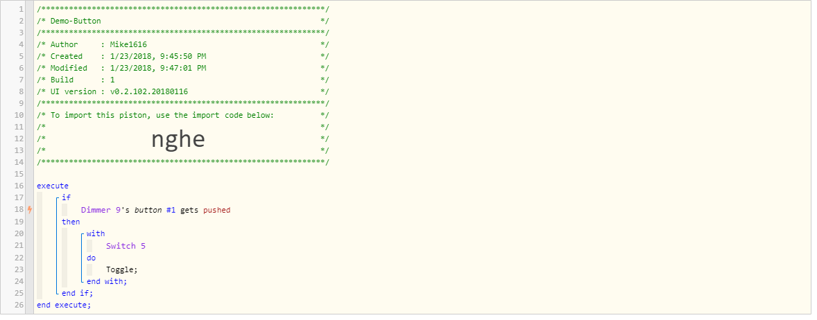

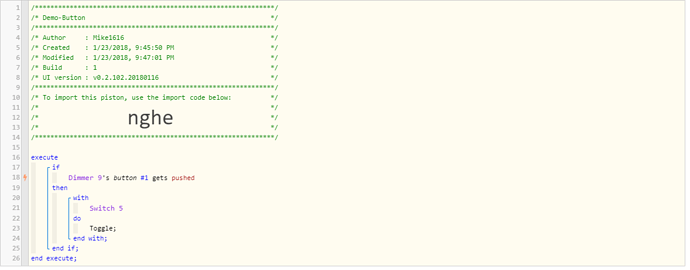

There’s a simple function in webCoRE that permits that in one command especially when you have a button. Toggle means exactly that. If it’s ON, turn it OFF and if it’s OFF turn it on. No need to test for anything as WC will figure out what to do and send the appropriate command.
Perfect thank you!! I was assuming I needed to add something after the toggle! Makes perfect sense!
