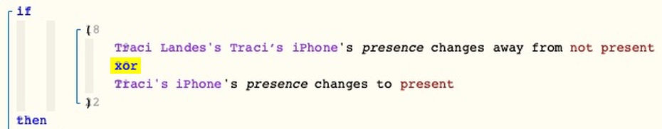

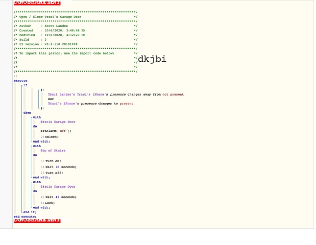

I’m brand new at this and trying to create a simple piston that opens the garage door when my wife arrives (using her iPhone as the trigger), or closes when she leaves the house using the same iPhone trigger. I’ve written the first half using someone else’s example, but it doesn’t seem to be working.
Door opens when presence arrives, closes when presence departs
The Garage door is nit opening upon arrival.
XOR is not the same as OR…
I would try changing it back to OR.

For troubleshooting (especially with a presence sensor), I also recommend turning Log Level to Full for a week or so. (with Trace turned on)
Pro Tip:
I understand why you tried to use XOR, but generally speaking, two triggers cannot be true at the same instant. This means that if Traci has two presence sensors, this piston will run twice when she arrives, and twice when she leaves. (with the former events processing the THEN block, and the latter events processing the ELSE block, if there is one)
