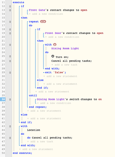

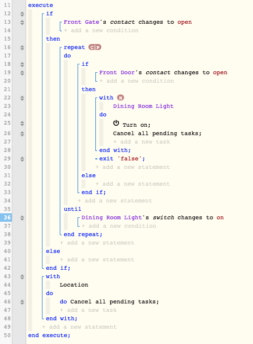

Simple if X trigger, then wait until Y trigger, then do Z
Trying to set up a simple piston that is activated on trigger X, then stays on standby until a following trigger Y happens, when that happens do Z.
Example. If my front yard gate opens, wait until the front door opens, then do something. In this way I can track the direction a person is moving.
Not sure if I am using the repeat feature correctly. Is this the best way to accomplish a if X wait till Y trigger? For the “until” in the repeat loop, is there an expression to say “until 5 minutes after the piston is first triggered?”
