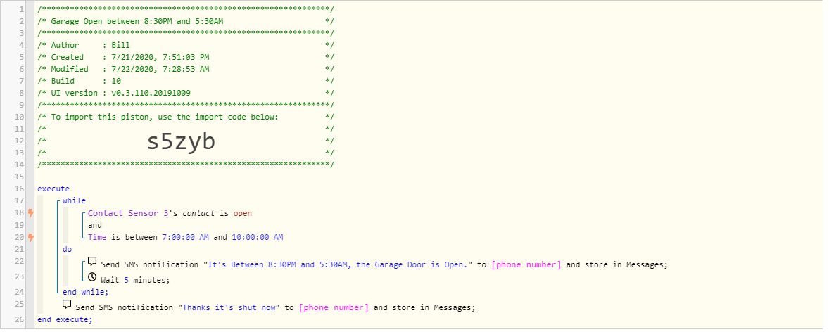

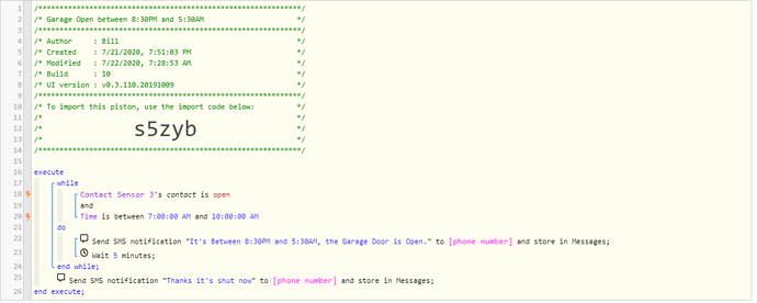

Hey guys, I’ve got a somewhat simple piston I’m working on, and I’m getting somewhere, I think I’m just having a problem with what to put where (well I guess isn’t that most issues)
When garage is open between 8:30pm & 5:30am, send text to phones (I have this working)
every 5 mins
Also have alexa speak every 5 mins that the garage is still open.
Once closed it will text us that it’s closed, then I’d like Alexa to say “Garage is now closed.”
I’m just not sure where to insert the alexa part of it. I have two sep. pistons but would like to learn to combine them into one.
I’m familiar with how to get alexa to speak, just wasn’t sure where I needed to add those lines in the same piston. Thanks for any help.

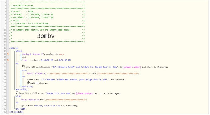

I think I got this thing figured out. :slight_smile:
Try this at line #25
IF Contact sensor changes to CLOSED
then
Send SMS
So I’m getting somewhere, but not quite there. Ike, haven’t made that change yet, but thought maybe you’d have a thought. So pretty much all day whenever I shut or open the door it says “Thanks it’s shut now.” :slight_smile: I only need it to warn me during those hours and then say thanks when it’s shut, not all day.
Then, just like your first IF block, you can use time frame as a condition
AND
IF yime is between X and Y
then
Send SMS or speak text etc
once you get this one working, you can explore EXPRESSIONS and echo can say the exact time.
“Time is 9:38 and the garage door is shut now.”

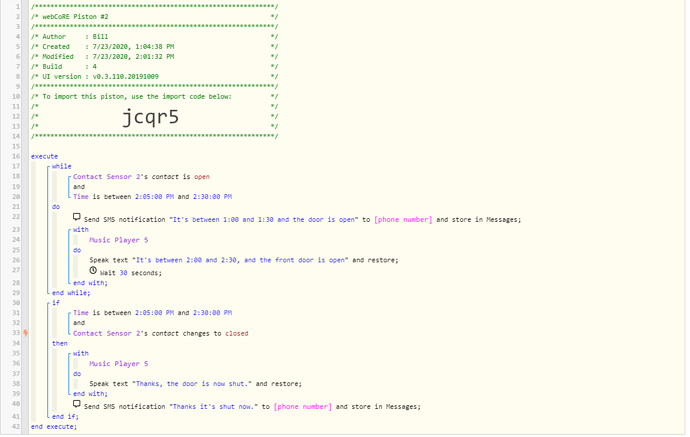

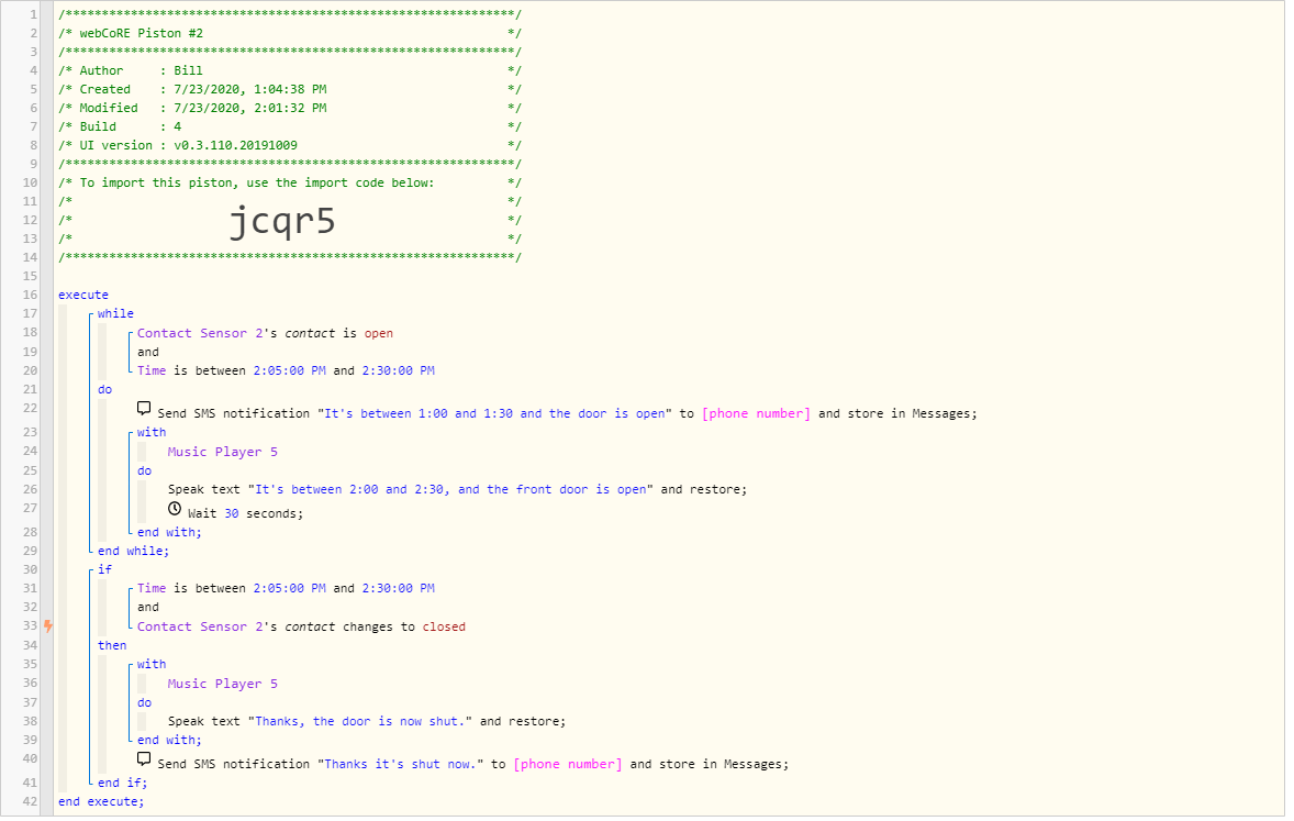

I’m doing some testing with my front door so I don’t have to keep opening/shutting my garage door, but I have the front door open, and had it set for 2:05 and 2:30, and expected it to alert me, but it’s not working. If I shut and reopen it works, but if I leave it open (which is the idea for the garage) Code is below
Notice the only lightning bolt in your left margin is next to Sensor 2’s contact.
This means currently, (contact change) is the only thing that will execute the piston.
Ahhhh…ok, dumb question, how the heck do I get the other lighting bolt.? :slight_smile: I’ll look on the help for now.
Notice how line 33 is a precise moment in time, and line 18 is a vague window?
I would drop the WHILE, and change line 18 to a precise IF:
IF Sensor 2's contact CHANGES TO open
   and Time is between X & Y
      Then do cool stuff
END IF
IF Sensor 2's contact CHANGES TO closed
      Then do other things
END IF
Note: If you want a repeat alert, more code would have to be added.

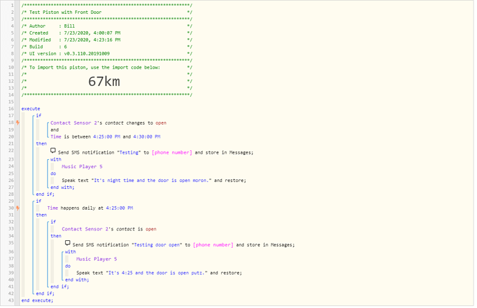

Ok, thank you this is helpful. So, the question I have though is:
If Sensor 2 is already open (meaning the door is open let’s say at 7:30PM and 8:00 PM rolls around and it’s open (time is between 8:00PM & 5:30AM)
If I focus on open doors, and temporarily ignore the repeat… I usually attack this from both angles:
IF Sensor's contact changes to open  <-- Trigger
   and Time is between X & Y         <-- Condition
      Then Send SMS
END IF
Every day at X                       <-- Trigger
   IF Sensor 2 IS open               <-- Condition
      Then Send SMS
   END IF
END EVERY
  • The top block catches new events during that time period…
  • The second block catches an already opened door at that time.

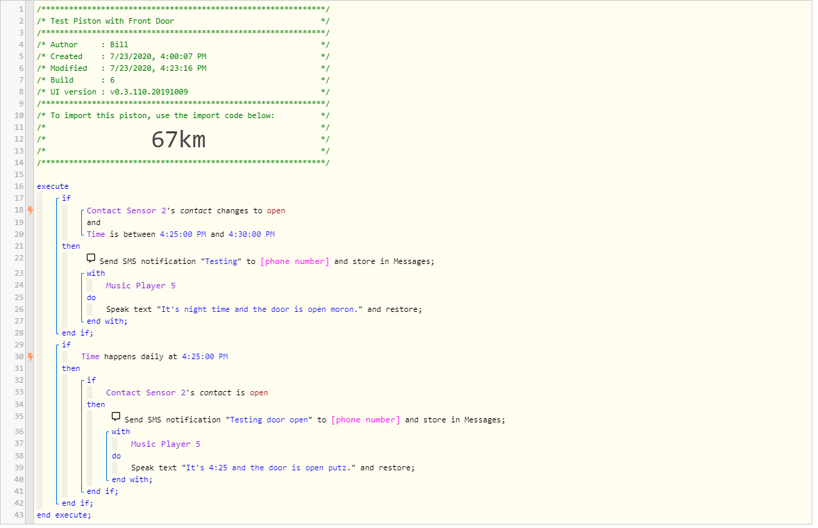

So I rewrote the script, and here’s what I have below. Only question I have is how do I get the alerts to keep coming if it stays open for both the first part of “changes to open” and the second part of currently open? I’d like SMS and Alexa alerts every 5 mins or so.
#19
It’s looking good so far, although my apologies… I don’t usually write loops while “off the clock”. To get you started though, (now that you have solid triggers in place), you can create a new block down below (outside the other two blocks) to cycle thru whatever.
IE: Your current triggers kicks off the piston, and your new block keeps it going.
Note: You will likely need to expand your time window to be successful at this.
Also keep in mind that there is a strict daily limit on SMS messages, and anything beyond the max will be lost forever.
