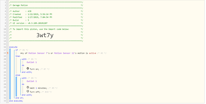

I finally getting around to using WebCoRE (awesome in scope it seems!) but can’t get my head around why this simple piston won’t turn off the lights.
I have a motion sensors in the garage (sensor 7) and utility room (sensor 11). I want the garage lights to come on if either sensor detects motion as the garage lights (controlled by a Fibaro relay - Outlet 1) are slow to come on and you walk through the utility room to get to the garage). I expect the lights to go off once motion stops from both sensors.
This work fine for turning the lights on if either sensor detects movement. The lights also turn off ok if they have been switched as a result of motion. The problem is that the lights never turn off if they have been switched on manually (e.g. using the physical lightswitch or in the Classic app) or by another automation (e.g when the presence sensor in my bike is detected, should I ever get it to work - though that’s for another post).

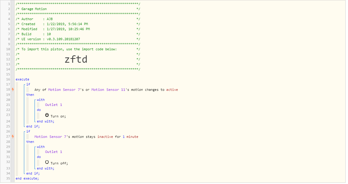

Hi @black-paladin
When use WAIT in most cases you have to adda NEVER CANCEL TASK
What you want is something like this
IF motion sensor changes to active
lights ON
IF motion sensor stays inactive 1 minute
Lights OFF
Two seperate IFs would do it…

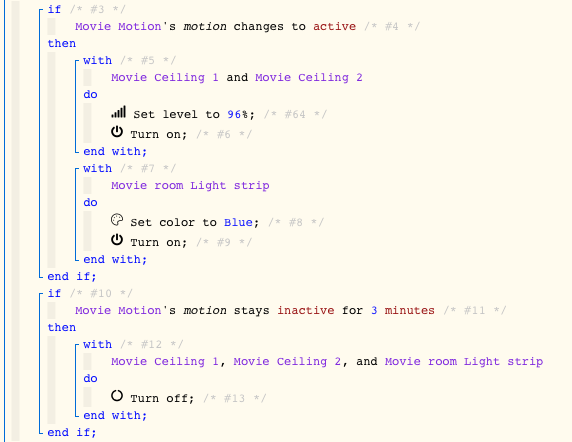

Here is one my pistons I use for entering the room lights ON, leaving the room and 3 minutes later lights OFF

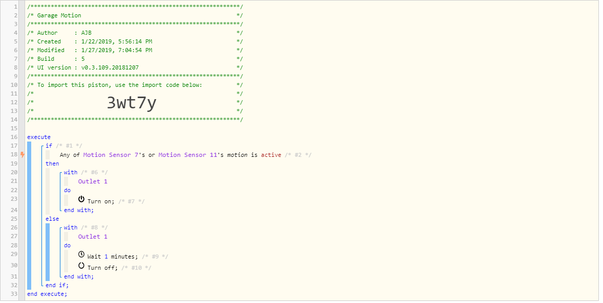

Many thanks @ike2018. I’ve modified the piston to mirror yours but I’m still getting the same behaviour. Oddly though, if I run “Test” in WebCoRE then after a minute the light turns off as expected. But if I just switch the light on (without motion in the Classic app) and leave it, it never turns off, so I’m still baffled.
Yes as expected…
Because when you switch the light ON with ST App your piston will never be triggered, 1 minute count down will never start.
If you turn it ON with the App, but walk into the room and leave…it will turn off because your piston is executed with motion.
Edit : It is possible to create a piston where if you turn the light ON with the app it turns it self OFF after a minute but you need more complex piston for that… I don’t truly understand the real life aplication of it?.. Would you want lights to be on even when there is no one in the room??? or you did that just for testing purposes?
Personally, after i started using webcore I kept ST app out of the picture in terms of automation. I wouldn’t recommend running your house using both.
So sorry I just saw the final part of your post. I should have read it better. My bad.
This is what you wanted from the get go.

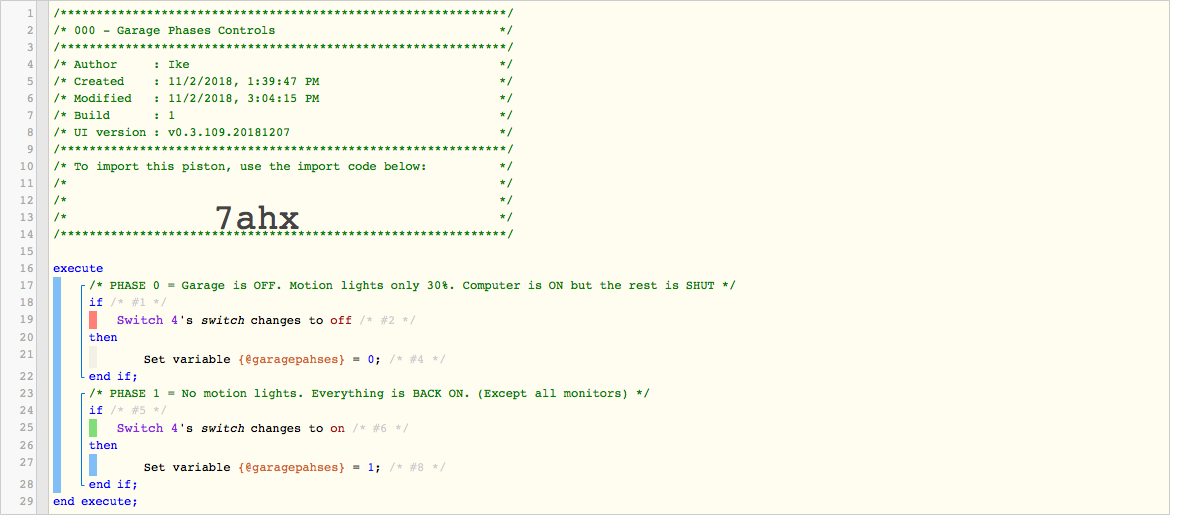

You will need another piston that changes global variable with certain triggers…
Other piston can look like this:
(Presense sensor)
IF my presense sensor changes to ACTIVE(HOME)
Set global variable @garage lights= 2
Turn light on
(manuel switch)
IF my switch changes to ON
Set global variable @garagelights = 2
Turn lights on
(you turn it on with ST app)
IF my bullb changes to ON
and
IF motions sensors have no motion
I wrote this very fasy i am sure it needs work…
I don’t know if you want to go down this road?
if yes, will work on it…

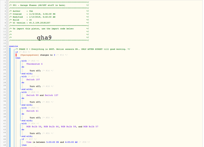

These two pistons are my gsarage controls with this PHASE system…
lots of other stuff is happening but it will give you an idea I guess.
