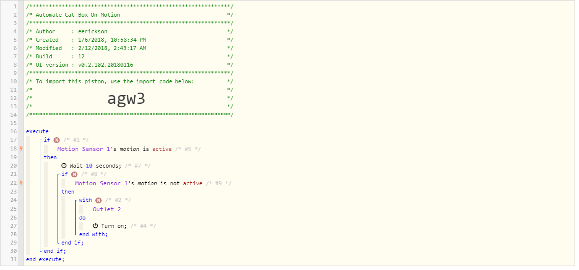

Here’s a snapshot of what I’m currently trying… this doesn’t trigger at all.

Is nor motion sensor going to inactive in 10sec? Can you turn on full logs and post the log
Right now the light will only go on if the motion sensor is not active 10s after it was active which seems odd to me
