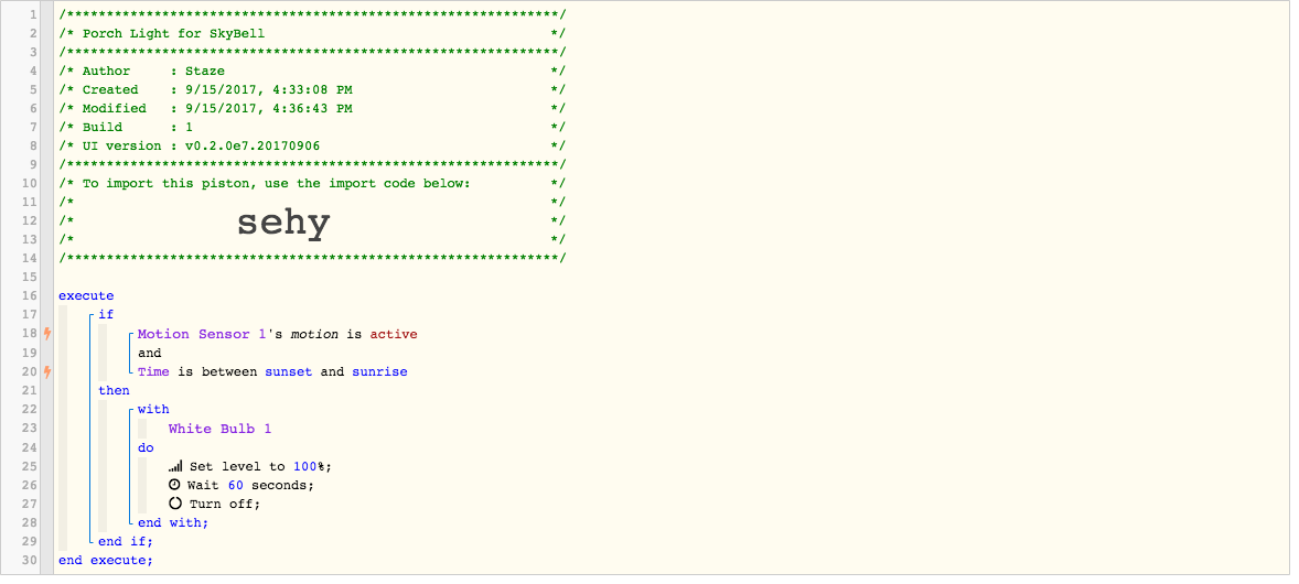

Skybell detects motion, turns on porch light, then waits 60s and turns it back off.
2 What is happening/not happening?
Light isn’t turning back off… -

“What it means is if there is a piston state or condition state change the task will cancel.
If you select ‘never’ then the task will always complete UNLESS the piston becomes true again. In that case the Timer stops. When it becomes false again, the Timer restarts. I hope that makes sense.”

the only thing you should need is TCP set to never and everything else set to default. it will work with that.
So everything else should be:
Description
Disabled No
Execution Method Synchronous
Task Cancellation Policy Never
Task Execution Policy Always
Task Scheduling Policy Override
