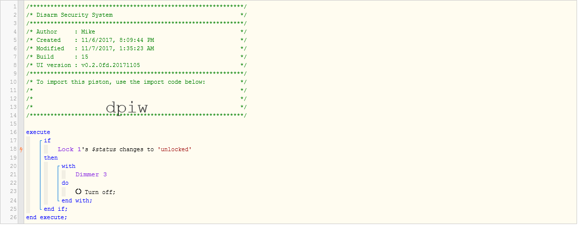

I trying to do a simple piston that will turn off a light if the door is unlocked. I’m assuming that I have to check “$status” of the lock but have no idea what the status should be. Where are the available $status parameters for the lock found?
This doesn’t work as written. Help!
Thanks!
Mike
Status is more the status it is showing to SmartThings. Should have some other options like lock or contact
That did the trick. Was trying to make it too hard.
