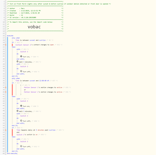

Simple Piston to turn on light for 5 minutes when door opens or with motion turns on but doesn't turn off!
It’s really a simple piston. Have outdoor light come on for 5 minutes if the door opens or motion is sensed: Light turns on just fine but the piston never executes turning off the light.
to just run this simple execution:
‘Turn On’
‘Wait 5 minutes’
‘Turn off’
The light turns on just fine and the log shows a wake-up set for 300seconds (5min) later, but then the piston never executes the wake-up to turn the light off!
You can see with the log below that the door opens and the light turns on at 7:32pm. As well a wake-up is set for 300 seconds later (7:37pm), but then the wakeup never takes place:

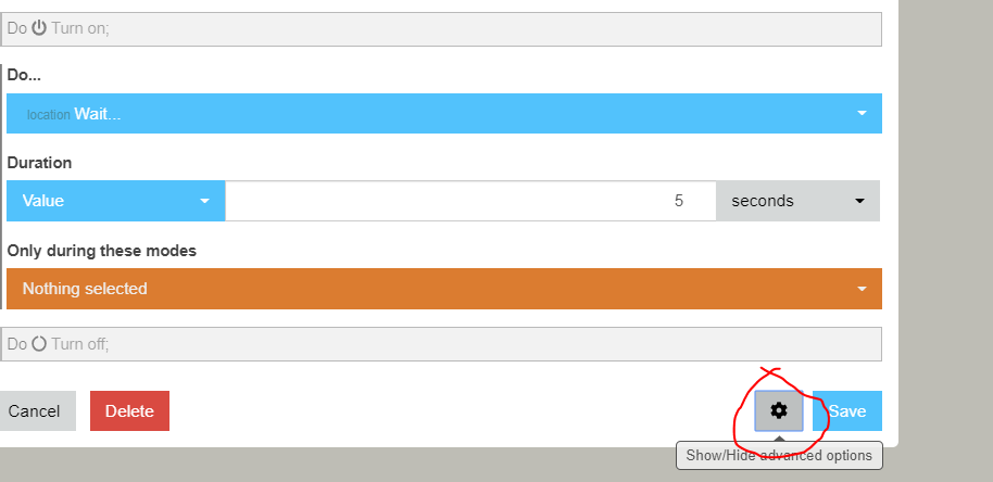

Have you tried setting the “Task Cancellation Policy” on each of the “With” statements to Never?
I have not but hopefully that is the problem! I just did some troubleshooting and light turns does turn off if the front door contact does not close first! but if the door opens, then shuts, for some reason the piston does not finish the ‘wait’.
Not sure how to change the task cancellation policy of the ‘wait’ . The advanced options wheel does NOT show how to do that. Can you please let me know.
Never mind. Found it. It is both under the master ‘if’ statement (which did not fix the problem) and under the swich itself (which DID fix the problem)
Thank you for the help! For me this is the most difficult part of WebCore to understand and remember to play with if things are not working right…
You may also want to consider a slight change to your code to simplify it.
With
Switch 3
Do
Turn on
End with
Wait 5 minutes
With
Switch 3
Do
Turn off
End with
Instead try
With
switch 3
Do
Turn on
Wait 5 minutes
Turn off
End with
:slight_smile:
When you start writing much larger pistons you will like this better
Personally, I like to break stuff like this up to avoid the semaphores and cancellation stuff.
Turn stuff on using whatever criteria you want. I would get rid of everything after the WAITs and just add this to the bottom…
If switch stays on for 5 minutes
AND motion is inactive
then turn off.
I also prefer this method…
No WAITs, and no messing with Task Cancellation Policy.
Yeah, @jkp I did do as you show originally and changed it to what I have now thinking it may make the difference but it obviously did not until I fixed the Task Cancellation Policy. Works both ways but your right it is better as you explain.
@Equis @WCmore I like the creative way around using the WAIT’s and dealing with the Task Cancellation issues… That is the cool thing about WebCore. More than one way to skin a cat…
The way I ACTUALLY do it is to use the motion sensor as the trigger…
If motion stays inactive for 5 minutes
and switch is on
Then turn off.
Poor cat. :wink:
