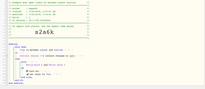

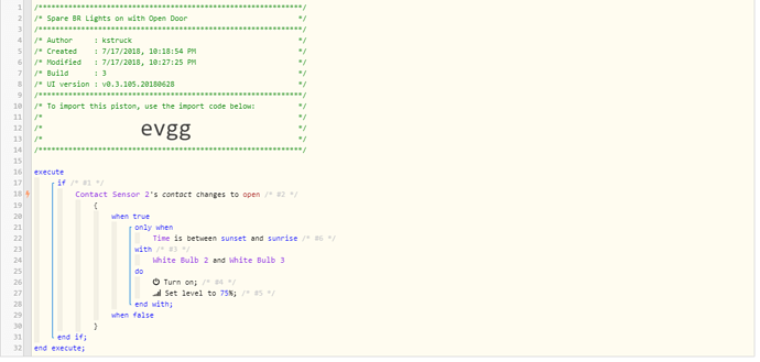

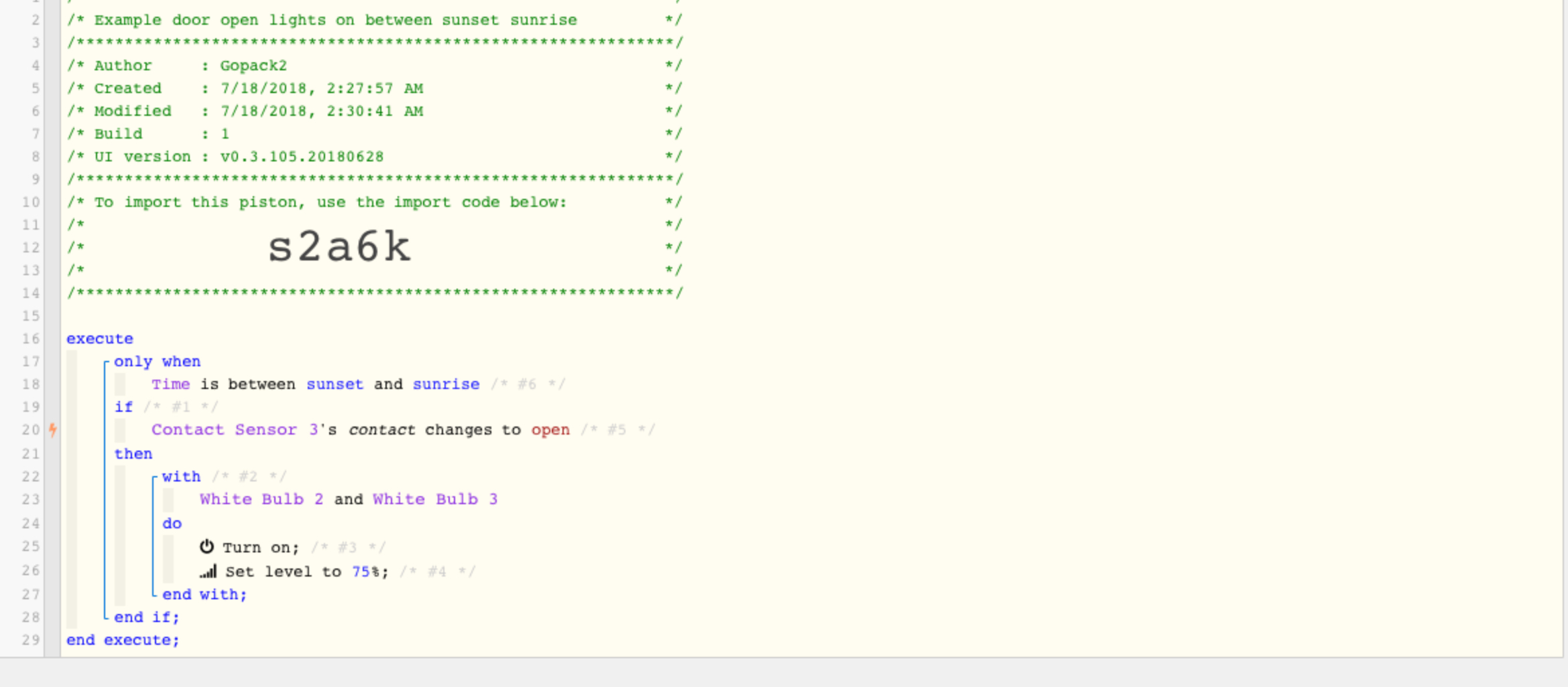

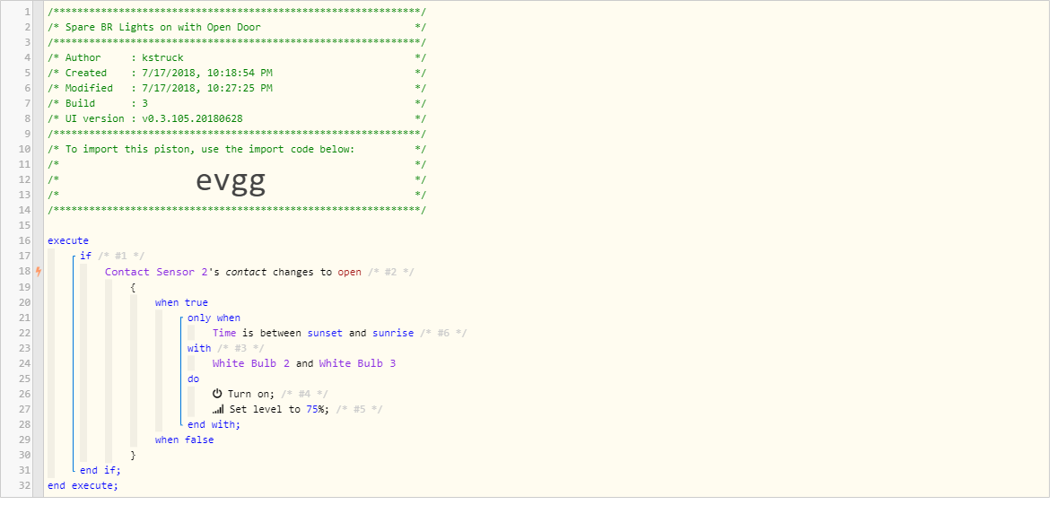

2 Hue A19 bulbs in a couple lamps. I have a contact sensor on the door. I want the lights to go on when the door sensor changes from close to open, only between sunset and sunrise. Currently, opening the door does not activate the lights.
Door sensor registers as open, but the lights do not go on.
