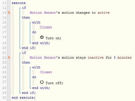

Hi guys,
I have a pretty simple piston that I find challenging to simplify due to me being new to webcore and not knowing its full functionality
I have a bunch of motion sensors controlling my lighting switches. IF (motion 1 changes) THEN (turn on switch A) ELSE (wait x minutes, turn off). Problem is, I have many repeated IFs THENs ELSEs for every motion sensors.
How can I simplify such a long piston using variables or anything else that can be used? Arrays?
Everything is happening fine, it’s a simple piston but needs simplifying.

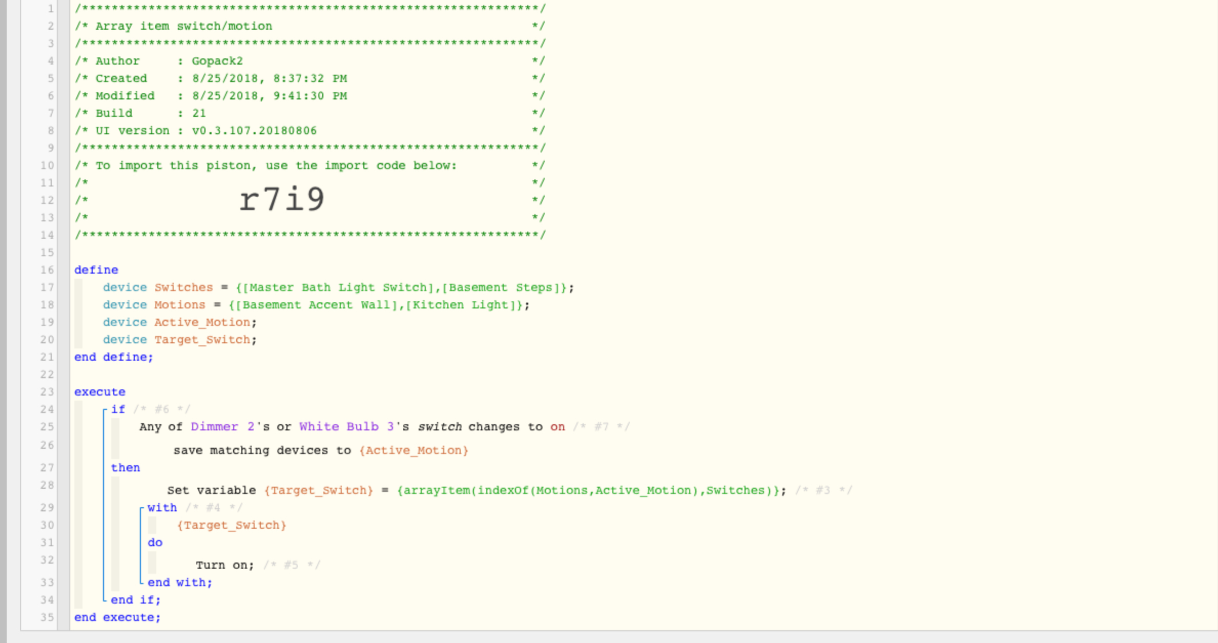

You could try an array. You would need to pair them in two different lists. Then use the array stuff to return which switch needs to be turned on. I personally have not tried that, but this sounds interesting.

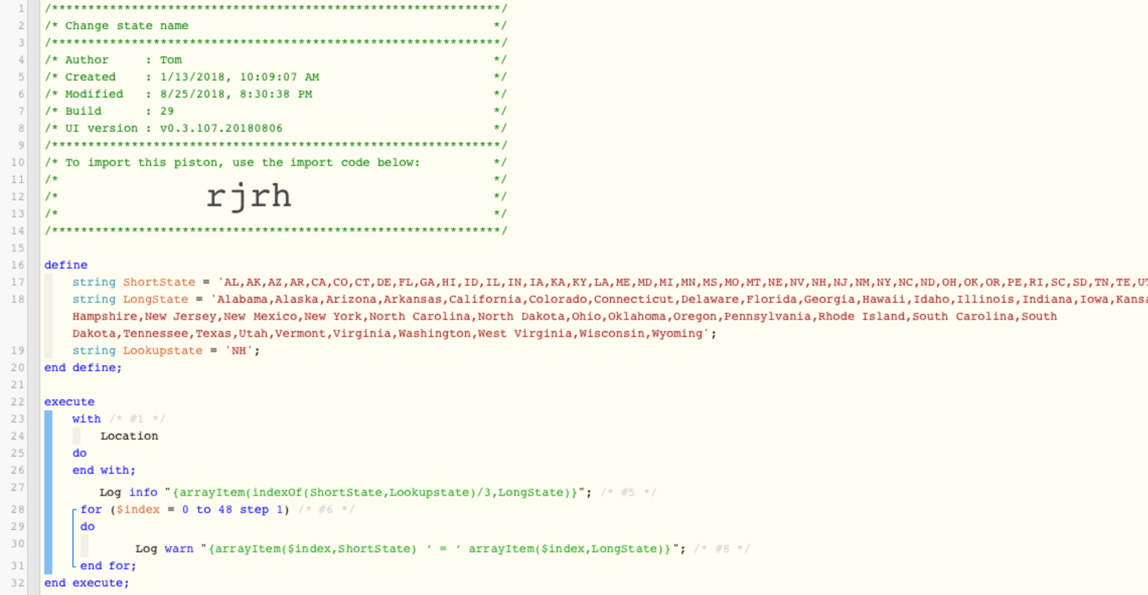

This might help you get started. I used this simple script to change state short names into state long names.
If you would put your motions in the short name variable and your switches in the long name variable… theoretically it should work. As long as you only have one switch for each motion detector.

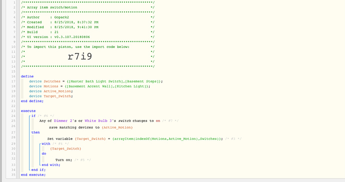

Maybe something like this.
Only thing is you can’t use wait commands to turn the lights off. They will over write each other each time one of the motion sensors triggers…
