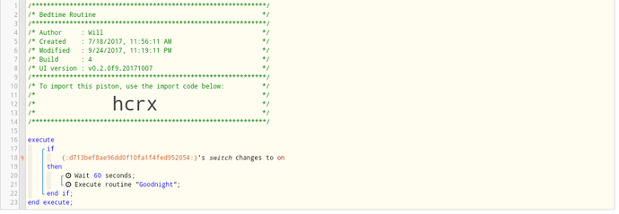

I can no longer select my simulated switches in WebCoRE. I used to be able to, but now they are all replaced with long strings of numbers and letters.
Simulated switches no longer available in WebCoRE
smartie
That means the device is no longer valid…Did you do something with that device? You have to go back into the Smart App and add any new devices…it will then see it (you’ll have to add it back)
