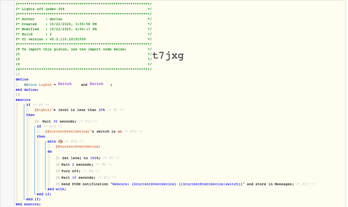

I have a fairly simple piston that monitors if a light is set below 20% and if so, waits 1 minute, sets the light’s level to 100, turns it off and sends a notification.
I want to apply this piston to many lights. Yes, I could just duplicate it X times one for each light, but it seems there is a more elegant solution that would handle all the lights in one piston and process each individually, simultaneously, if multiple lights are set under 20% at the same time. I can’t get that to work though.
See above
I tested with two lights. The lights that triggered the piston first were NOT turned off/notification sent, but the lights that triggered the piston second WERE turned off/notification sent.
Piston working with one light:
Piston not working with multiple lights:
10/22/2020, 4:11:46 PM +596ms
+6ms ╔Received event [187 Montgomery Avenue Hubitat].time = 1603397506993 with a delay of -397ms, canQueue: true, calledMyself: false
+28ms ║RunTime initialize > 27 LockT > 1ms > rtDT > 2ms > pistonT > 1ms (first state access 24 7 20)
+31ms ║Runtime (6960 bytes) successfully initialized in 2ms (v0.3.110.20200916_HE)
+34ms ║Synchronizing scheduled event, waiting for 364ms
+430ms ║╔Execution stage started
+452ms ║║Comparison (enum) off is (string) on = false (3ms)
+454ms ║║Cancelling condition #15's schedules...
+455ms ║║Condition #15 evaluated false (10ms)
+457ms ║║Cancelling condition #14's schedules...
+458ms ║║Condition group #14 evaluated false (state changed) (14ms)
+463ms ║╚Execution stage complete. (33ms)
+466ms ╚Event processed successfully (464ms)
10/22/2020, 4:11:27 PM +403ms
+5ms ╔Received event [187 Montgomery Avenue Hubitat].time = 1603397487265 with a delay of 138ms, canQueue: true, calledMyself: false
+28ms ║RunTime initialize > 27 LockT > 1ms > rtDT > 3ms > pistonT > 2ms (first state access 23 6 21)
+31ms ║Runtime (6952 bytes) successfully initialized in 3ms (v0.3.110.20200916_HE)
+34ms ║╔Execution stage started
+49ms ║║Calculating (string)Webcore: + (string)Master bedroom lights >> (string)Webcore: Master bedroom lights
+51ms ║║Calculating (string)Webcore: Master bedroom lights + (string) >> (string)Webcore: Master bedroom lights
+54ms ║║Calculating (string)Webcore: Master bedroom lights + (string)off >> (string)Webcore: Master bedroom lights off
+128ms ║║Executed virtual command [Master bedroom lights].sendPushNotification (67ms)
+136ms ║╚Execution stage complete. (102ms)
+158ms ║Setting up scheduled job for Thu, Oct 22 2020 @ 4:11:46 PM EDT (in 19s)
+160ms ╚Event processed successfully (159ms)
10/22/2020, 4:11:17 PM +263ms
+5ms ╔Received event [187 Montgomery Avenue Hubitat].time = 1603397477224 with a delay of 39ms, canQueue: true, calledMyself: false
+77ms ╚Event queued (75ms)
10/22/2020, 4:11:16 PM +911ms
+4ms ╔Received event [Master bedroom lights].level = 99 with a delay of 48ms, canQueue: true, calledMyself: false
+52ms ║RunTime initialize > 51 LockT > 1ms > rtDT > 1ms > pistonT > 0ms (first state access 49 5 46)
+56ms ║Runtime (6926 bytes) successfully initialized in 1ms (v0.3.110.20200916_HE)
+57ms ║╔Execution stage started
+70ms ║║Comparison (integer) 10 is_less_than (integer) 20 = true (2ms)
+72ms ║║Condition #2 evaluated true (10ms)
+74ms ║║Condition group #1 evaluated true (state did not change) (12ms)
+75ms ║║Cancelling statement #12's schedules...
+79ms ║║Executed virtual command wait (1ms)
+82ms ║║Requesting a wake up for Thu, Oct 22 2020 @ 4:11:46 PM EDT (in 30s)
+90ms ║║Synchronizing scheduled event, waiting for 224ms
+342ms ║║Executed physical command [Master bedroom lights].off() (14ms)
+344ms ║║Executed [Master bedroom lights].off (17ms)
+351ms ║║Executed virtual command [Master bedroom lights].wait (1ms)
+353ms ║║Requesting a wake up for Thu, Oct 22 2020 @ 4:11:27 PM EDT (in 10s)
+361ms ║╚Execution stage complete. (303ms)
+383ms ║Setting up scheduled job for Thu, Oct 22 2020 @ 4:11:27 PM EDT (in 10s), with 1 more job pending
+386ms ╚Event processed successfully (384ms)
10/22/2020, 4:11:15 PM +133ms
+6ms ╔Received event [187 Montgomery Avenue Hubitat].time = 1603397475060 with a delay of 73ms, canQueue: true, calledMyself: false
+25ms ║RunTime initialize > 24 LockT > 1ms > rtDT > 2ms > pistonT > 1ms (first state access 21 7 17)
+27ms ║Runtime (6785 bytes) successfully initialized in 2ms (v0.3.110.20200916_HE)
+48ms ║║Comparison (enum) on is (string) on = true (2ms)
+50ms ║║Cancelling condition #15's schedules...
+53ms ║║Condition #15 evaluated true (10ms)
+55ms ║║Cancelling condition #14's schedules...
+56ms ║║Condition group #14 evaluated true (state changed) (14ms)
+60ms ║║Cancelling statement #16's schedules...
+81ms ║║Executed physical command [Master bedroom lights].setLevel([100], ) (15ms)
+83ms ║║Executed [Master bedroom lights].setLevel (17ms)
+88ms ║║Executed virtual command [Master bedroom lights].wait (0ms)
+90ms ║║Requesting a wake up for Thu, Oct 22 2020 @ 4:11:17 PM EDT (in 2s)
+98ms ║╚Execution stage complete. (67ms)
+120ms ║Setting up scheduled job for Thu, Oct 22 2020 @ 4:11:17 PM EDT (in 2s)
+123ms ╚Event processed successfully (122ms)
10/22/2020, 4:10:45 PM +8ms
+3ms ╔Received event [Master bedroom lights].level = 10 with a delay of 61ms, canQueue: true, calledMyself: false
+20ms ║RunTime initialize > 19 LockT > 2ms > rtDT > 2ms > pistonT > 1ms (first state access 15 5 14)
+22ms ║Runtime (6763 bytes) successfully initialized in 2ms (v0.3.110.20200916_HE)
+24ms ║╔Execution stage started
+37ms ║║Comparison (integer) 10 is_less_than (integer) 20 = true (2ms)
+39ms ║║Condition #2 evaluated true (12ms)
+41ms ║║Condition group #1 evaluated true (state did not change) (14ms)
+43ms ║║Cancelling statement #12's schedules...
+49ms ║║Executed virtual command wait (0ms)
+52ms ║║Requesting a wake up for Thu, Oct 22 2020 @ 4:11:15 PM EDT (in 30s)
+61ms ║╚Execution stage complete. (37ms)
+89ms ║Setting up scheduled job for Thu, Oct 22 2020 @ 4:11:15 PM EDT (in 30s)
+91ms ╚Event processed successfully (90ms)
10/22/2020, 4:10:32 PM +815ms
+3ms ╔Received event [Layla’s lights].level = 10 with a delay of 59ms, canQueue: true, calledMyself: false
+56ms ║RunTime initialize > 55 LockT > 2ms > rtDT > 41ms > pistonT > 40ms (first state access 12 5 50)
+60ms ║Runtime (6693 bytes) successfully initialized in 41ms (v0.3.110.20200916_HE)
+62ms ║╔Execution stage started
+78ms ║║Comparison (integer) 10 is_less_than (integer) 20 = true (3ms)
+80ms ║║Condition #2 evaluated true (14ms)
+82ms ║║Condition group #1 evaluated true (state did not change) (16ms)
+84ms ║║Cancelling statement #12's schedules...
+93ms ║║Executed virtual command wait (2ms)
+102ms ║║Requesting a wake up for Thu, Oct 22 2020 @ 4:11:02 PM EDT (in 30s)
+115ms ║╚Execution stage complete. (53ms)
+138ms ║Setting up scheduled job for Thu, Oct 22 2020 @ 4:11:02 PM EDT (in 30s)
+140ms ╚Event processed successfully (138ms)
