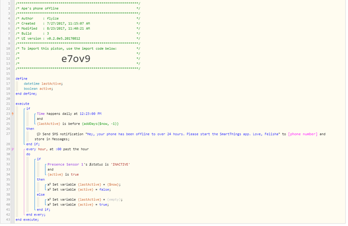

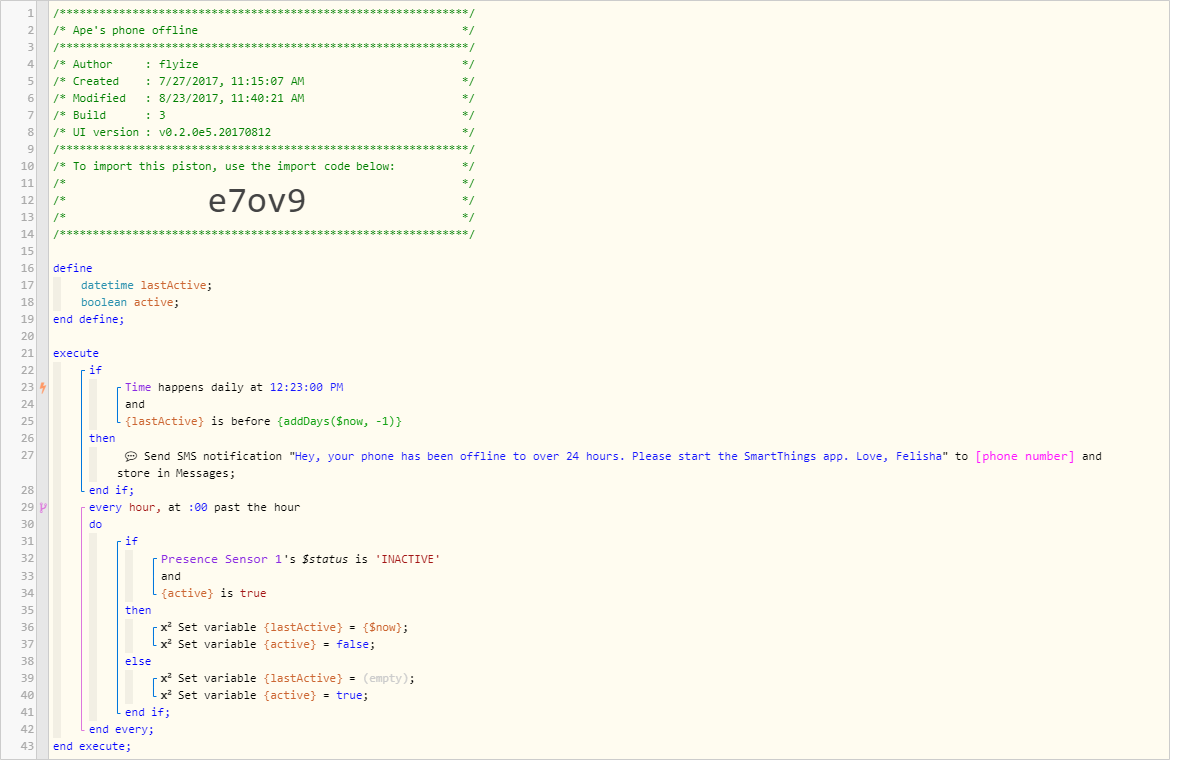

I’ve attempted to write a piston that alerts me if a phone has been offline for more than a day. Unfortunately, it doesn’t seem to be working correctly. What am I doing wrong?
Since the ST app's presence detection is so bad
try this
if time happens daily at 12:23pm
and
lastactive is before addDays($now, -1)
send SMS
end if
every hour at :00 past the hour
if presence sensor 1's $status is not 'INACTIVE'
set variable lastActive = $now
end if
end every
Hey, that’s much simpler. I still think there might be an issue with properly detecting the $status, but I’ll let you know shortly.
Thanks.

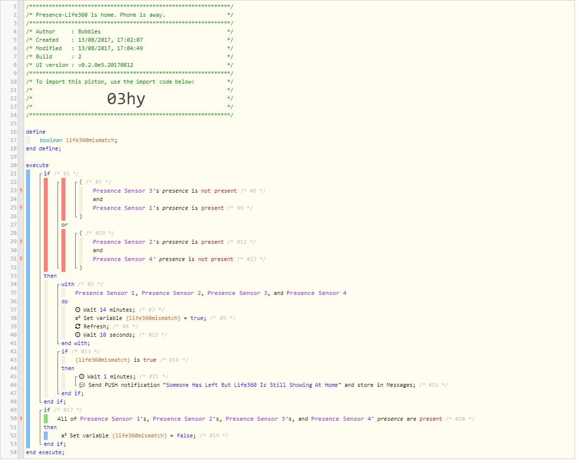

Do you use Life360?
I find it more reliable the the ST presence.
I then use Life360 to do a comparison check for me.

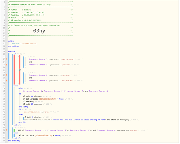

Here it is in case you do use Life360 and you want to use it.

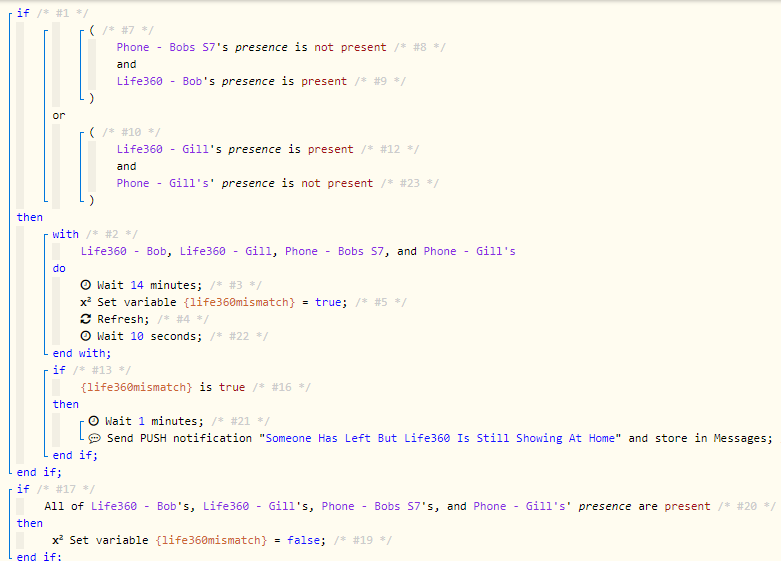

I’m using Life360 for that exact reason… Really struggle with the ST presence. Is this piston comparing Life360 with ST presence or is it validating Life360 status? I sometimes have issues with Life360 and looking for a logic so I pick up when things have gone wrong so I can manually check-in and force an update from Life360…
Its comparing Life360 against ST phone presence. If the phone is away but Life360 is present it sends me a notification. Just gives me an idea if a phone has gone awol.
