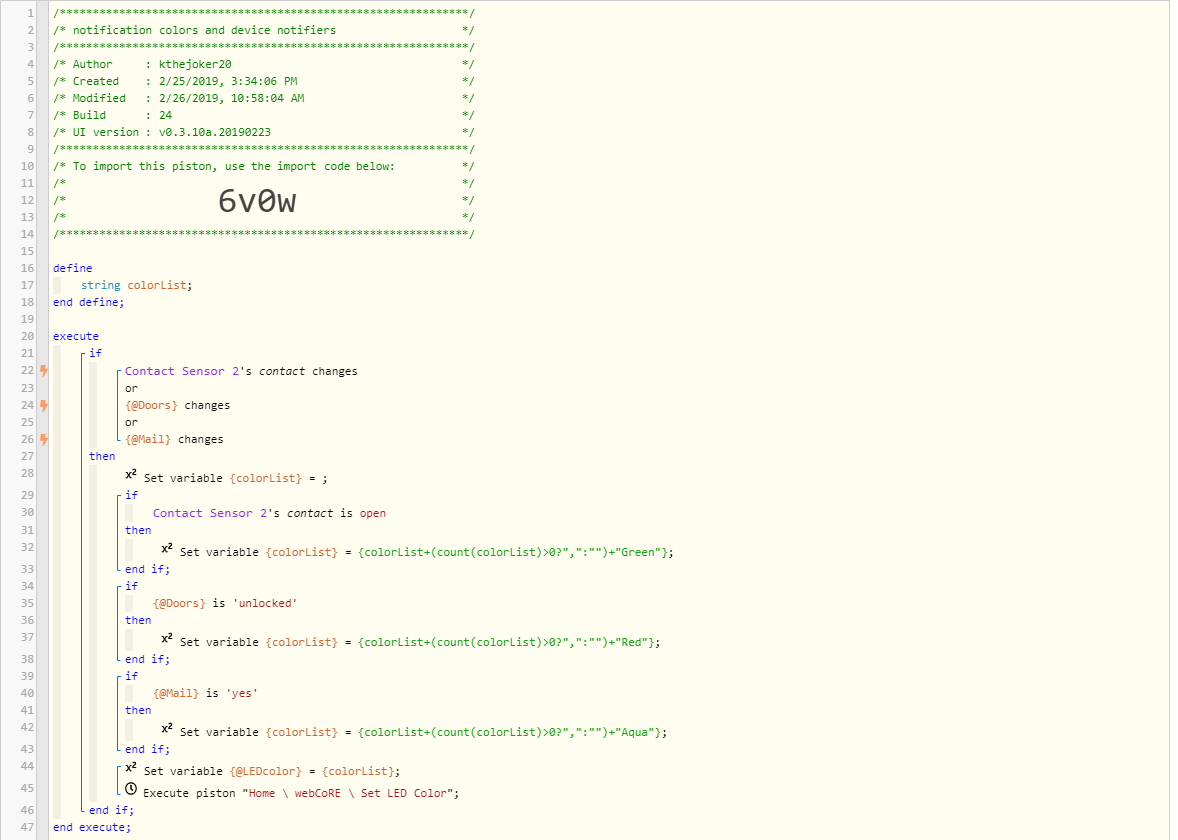

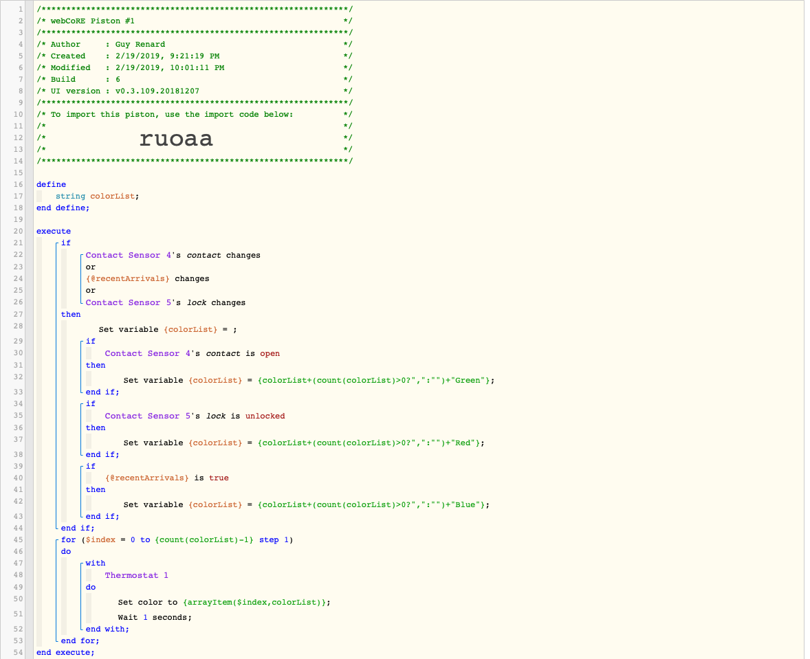

Try this out. I don’t have a color changing LED but you can put your devices back in where appropriate. Basically, every time one of the conditions change, this updates the color list and then cycles through the colors. You will have to add the repeat if that is what you want also.
Wow this is a great improvement. Never thought to do it that way.
One problem though, the lights are staying on. So say, I open the door, the light goes red. Then I close door. The light doesn’t go out.
I think in each group for the else statement, I need to figure out a string to remove the color from the color list. So if that device is closed, the color should be remove so that the color no longer flashes.
Here is my update piston.
Hmm. The way I wrote it, the list starts blank each time. It is supposed to trigger on any change (open/close or true/false) and then rebuild the list based on the current conditions. Strange that it is not turning off. You can go into the piston and see what the latest value is for the color list and perhaps see the logs. When the door closes, that light should no longer make it into the list.
When you say doesn’t turn off, you mean it stays on continuously? Two things I didn’t;t do from your original post. I didn’t make the colors repeat (it only goes through he list once) and I didn’t;t turn the light off. You can add an off command to the end and/or add a repeat wrapper around the for loop.

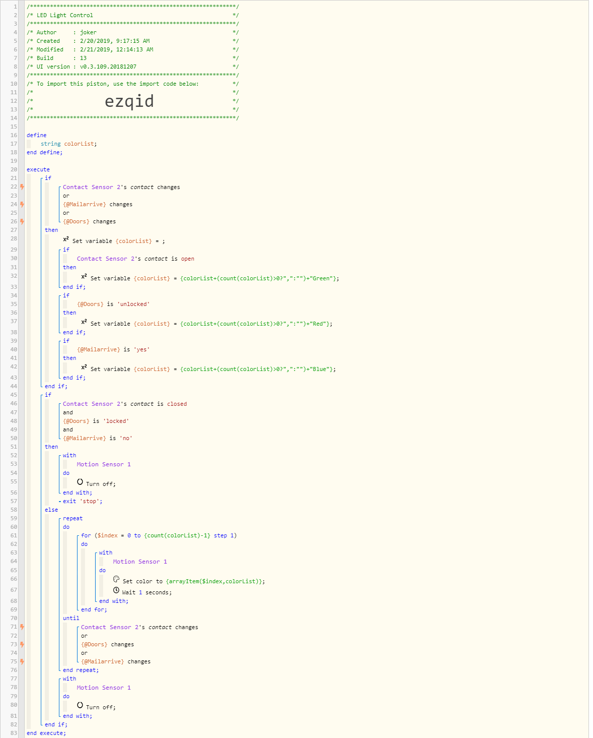

Ok did some tinkering and added the repeat loop.
I think what it was missing, is what to do if all the devices were off, which would be to shut off the led.
Here is what i got, but it looks messy.

I think within the first if, you could hold just add another if:
If count(colorList) is 0
    Turn off
     Exit
Endif
The above statement worked great. The lights shuts off now.

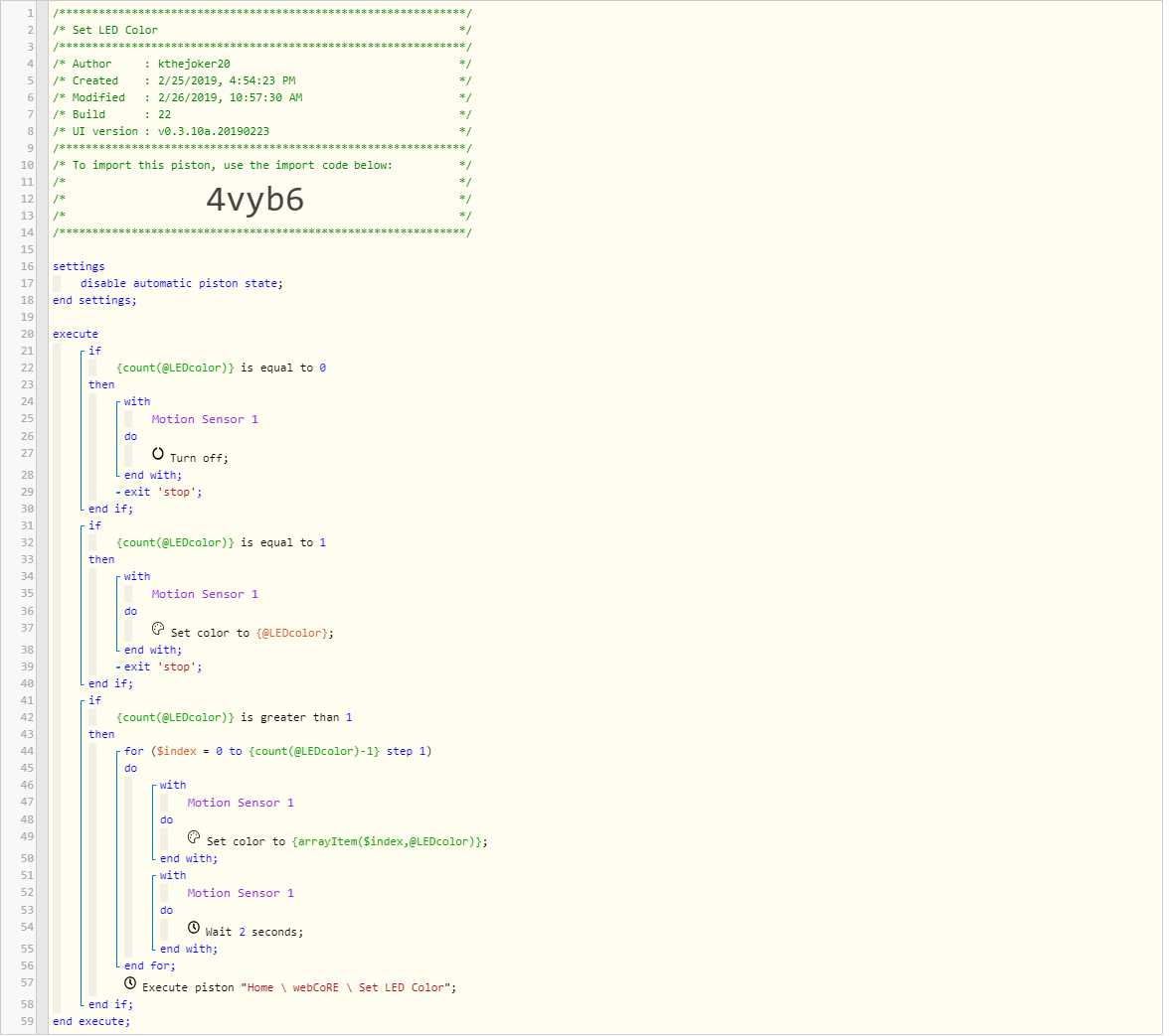

Piston 1 setting the colors per device notification

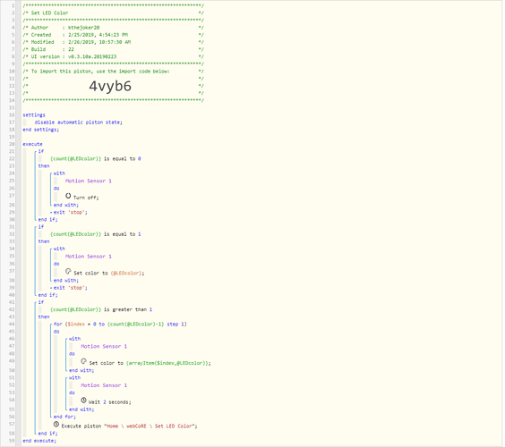

Piston 2 Setting the color on the single light, cycling through colors if multiple notifications
Further testing, it only cycles 7 times, then it stops again.
It works fine with other light bulbs RGBs, no problem.
I am using it on the EZmultipli LED sensor. I wonder if this is a device handler or firmware problem at this point.
In piston 2, I don’t think you need the second if. I think it should just look like:
if count is 0
 turn off
 exit
end if
for index=0 to count step 1
do
  set color
  wait 3 second
end for
Note that the set color and the wait can be in the same ‘with’. no need to separate them.
As for your repeat problem, I don’t see where you have implemented any repeat at all. This is only going to run through once for each event so you may only be seeing the cycles associated with turning on/opening each device. I forget, did you want this to loop indefinitely or what was the trigger to stop repeating?
I want it to loop indefinitely.
Then when any of the triggers from the other piston change, that will fire the piston again.
If the state changes to 0 or 1, those will stop the piston from repeating, and leave the color solid.

OK, then you need to wrap a repeat loop around the for loop. You will have to drag the for loop into the do section of the repeat loop. For the ‘until’ condition, I suggest you use count(@LEDcolor) is 0.

I have heard the semaphore wait is usually indicative of too much traffic causing lag. Perhaps try changing the wait to 3 or 5 seconds and see if it works better.
