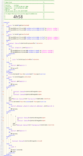

Skipped physical command
Setup : Door with zwave lock and door sensor
When door is opened and closed. Door lock doesnt lock.
Lock automatically when door closed

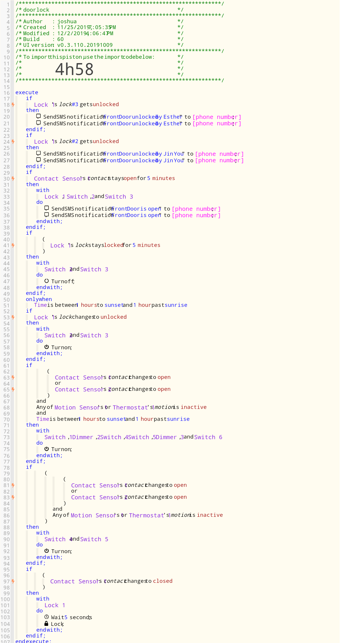

(PASTE YOUR LOGS HERE THEN HIGHLIGHT ALL OF THE LOGS AND CLICK ON THE </> ICON TO FORMAT THEM CORRECTLY)REMOVE BELOW AFTER READING*
Three things…
  1. Your piston graphic did not post correctly and it is difficult to read. Use the Green snapshot button to post it.
  2. You have 10 (ten) triggers (orange lightening bolts in the left margin) in your piston. It can sometimes be very difficult to debug such a piston.
  3. Can you use Trace and post a log with Trace switched on?
Can you construct your piston(s) to use a single trigger and maybe some conditions and focus on one specific task per piston? That will make debugging much easier.
