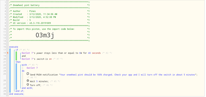

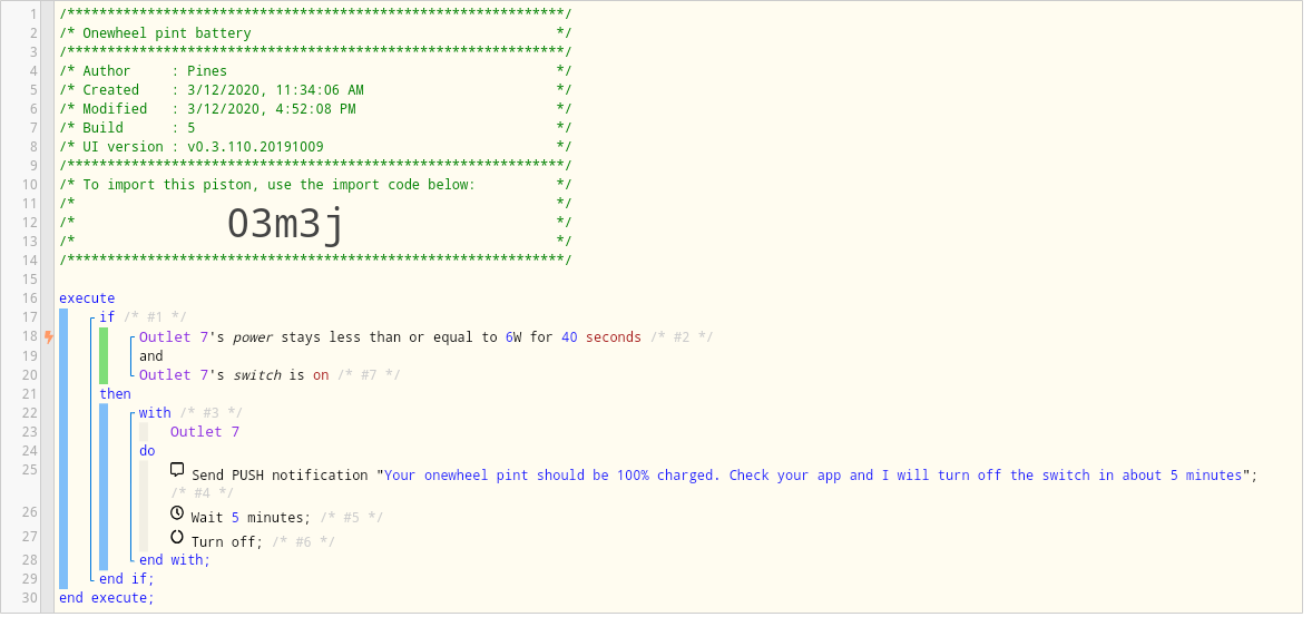

Is it possible for an IRIS Smart plug to know when a device (OneWheel) is fully charged and to turn off when it reaches 100%
If OneWheel is at 100 turn off the smart plug (I assume based on energy usage).
Not sure how to measure 100% power
**4) Post a Green Snapshot of the Piston
N/A
