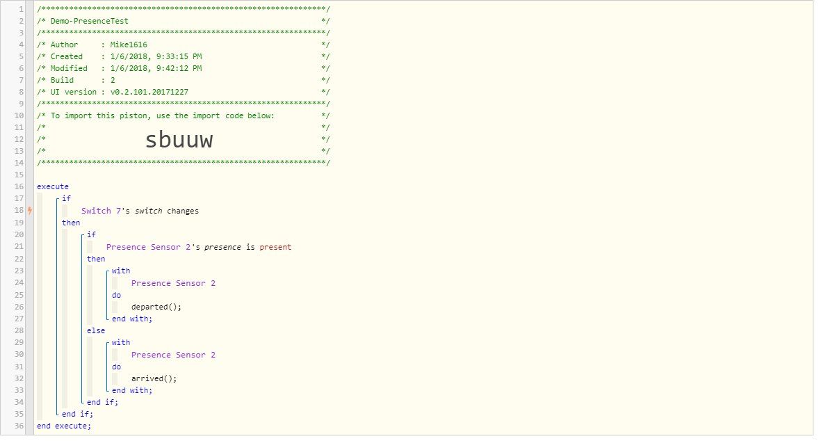

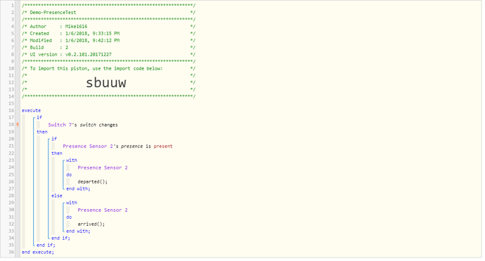

IF Button changes THEN
IF vPresence is Present THEN
Departed()
ELSE
Arrived()
Slight hiccup, the switch works but there s weird action that keeps happening.
Presence sensor is departed
I click the momentary switch
Presence sensor marked as present but then immediately afterward it goes back to departed
But if I keep pressing the momentary switch it will stick to present and stay present.
Hmmm… Maybe it being a momentary switch is causing the piston to fire on both the Press down and the Release Up (that’s a guess…but it could be true).
Turn logging on to full and post the logs of what the piston is doing. We can look at that. Or just add some debug logging and see if it’s running twice for each press on the momentary switch.
