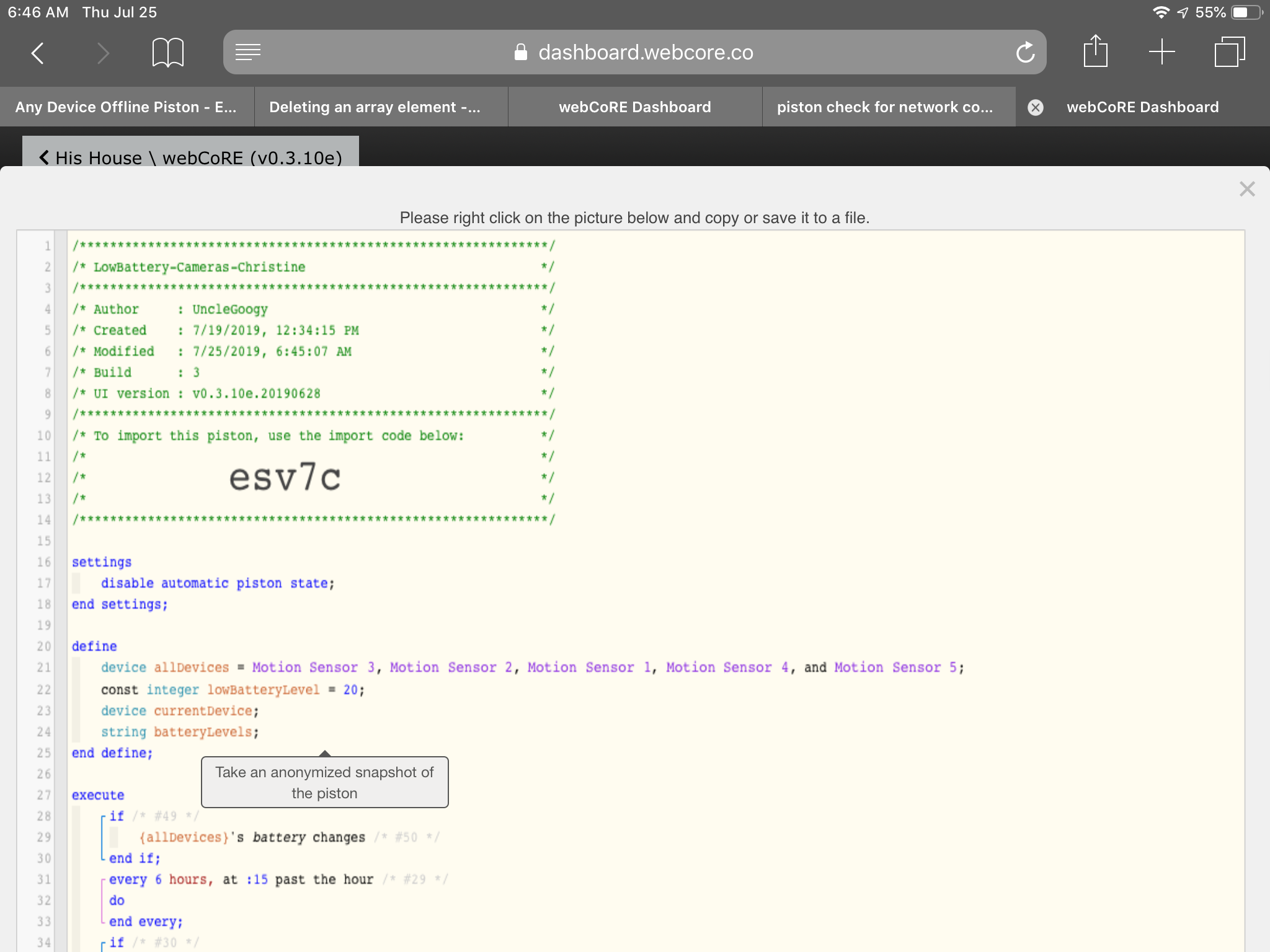

Piston to monitor and alert on low battery levels. I copied and tweaked this piston. I get multiple SMS notifications but I can’t see why. Appears to be out of FOREACH loop to me, but I get multiple notifications - always a multiple of number of devices below battery threshold.
Only one notification per 24 hours or change in batt level on any monitored device
Receiving multiple SMS notifications instead of just one.
