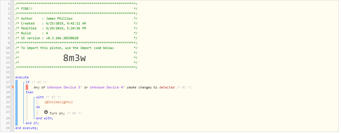

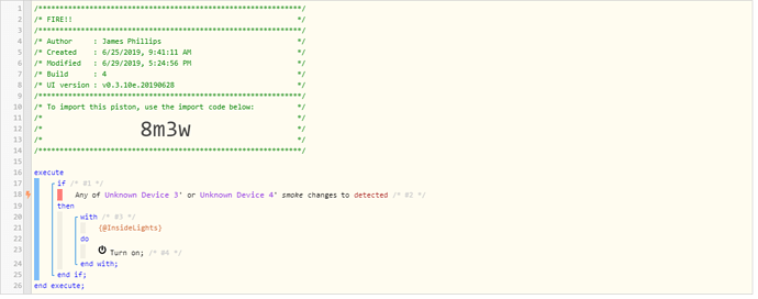

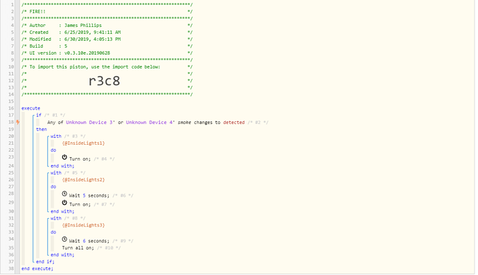

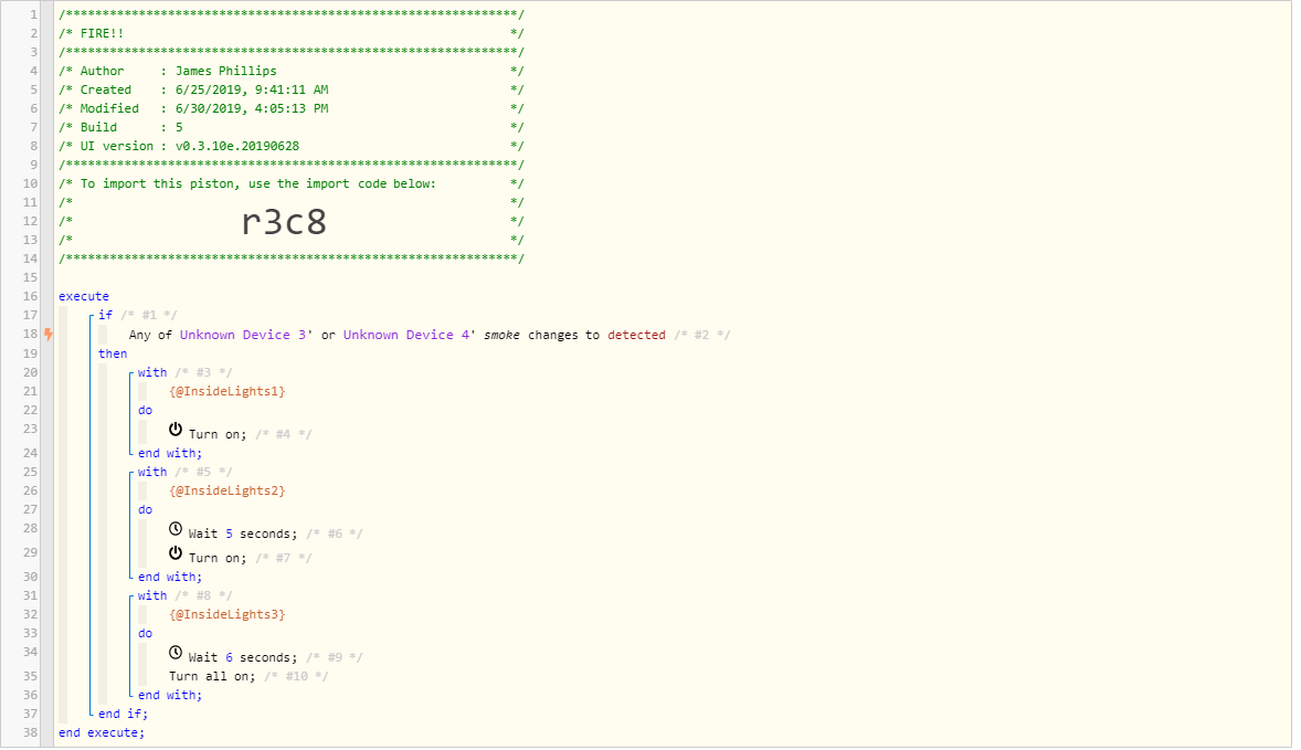

I want the lights to turn on when the smoke detector says that smoke or carbon monoxide is detected. So far, the tests I have run have not changed the lights to on
Lights should turn on
The lights are unaffected
