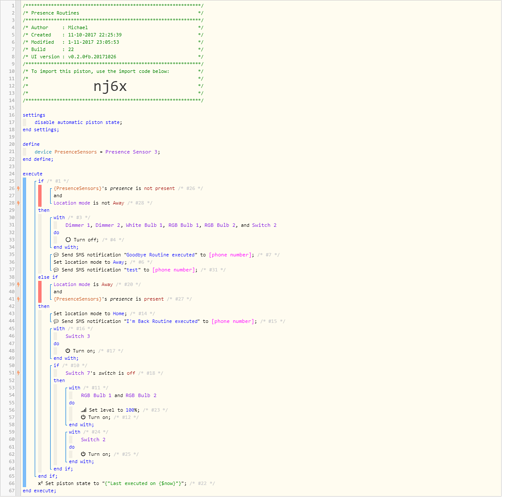

So i’ve had a piston for a while and suddenly it isn’t sending sms notifications anymore.
I added a new one to send “test” and it is sending that one but not the other one…
It’s not sending “Goodbye Routine executed” and “I’m back routine executed”.
I don’t really understand whats happening.
Sms notifications
Is there a chance that you set up the modes to change in response to presence devices directly in SmartThings? I could imagine a race condition here where ST is also setting the mode, happens to get to it before webCoRE is triggered, and then the piston doesn’t do anything since the mode is already correct.
Well the lights turn on and off, so i’m sure it’s being triggered. Today it did send the sms notification, not sure what is going on…

Yea lately i’ve been having random issues. It just doesn’t send some and i’m not sure why.
