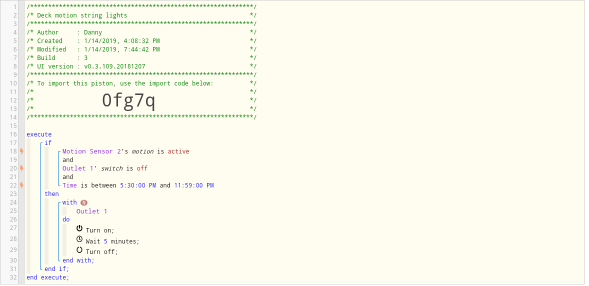

When my deck lights turn off it sets off my motion camera and turns lights back on.
Ring camera motion is detected and string lights are off then turn on deck string lights. Wait 5 minutes. Turn off deck string lights.
Motion is detected and turns on lights. When lights turn off after 5 minutes it triggers my motion and triggering the lights to turn on again. After 5 minutes lights turn off and triggers the motion again turning on my lights. Creating a loop of on and off

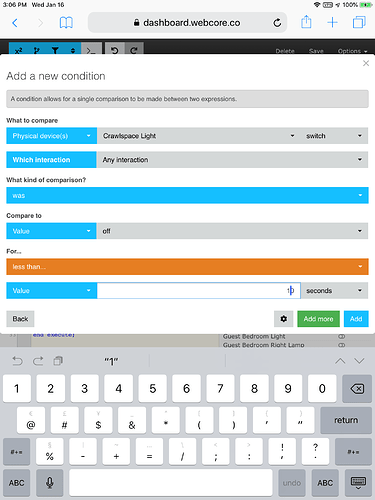

Try in place of switch 1 is off —> switch 1 was off for at least 10 seconds
You may also want to change motion is active —> motion changes to active
That sounds exactly like what I need to do. I can’t seem to see how to change switch is off to was off for at least 10 seconds.
Sorry pretty new to this and still learning
The orange line can be changed to at least. I was in a rush To post the screen shot that I forgot to edit that line.
