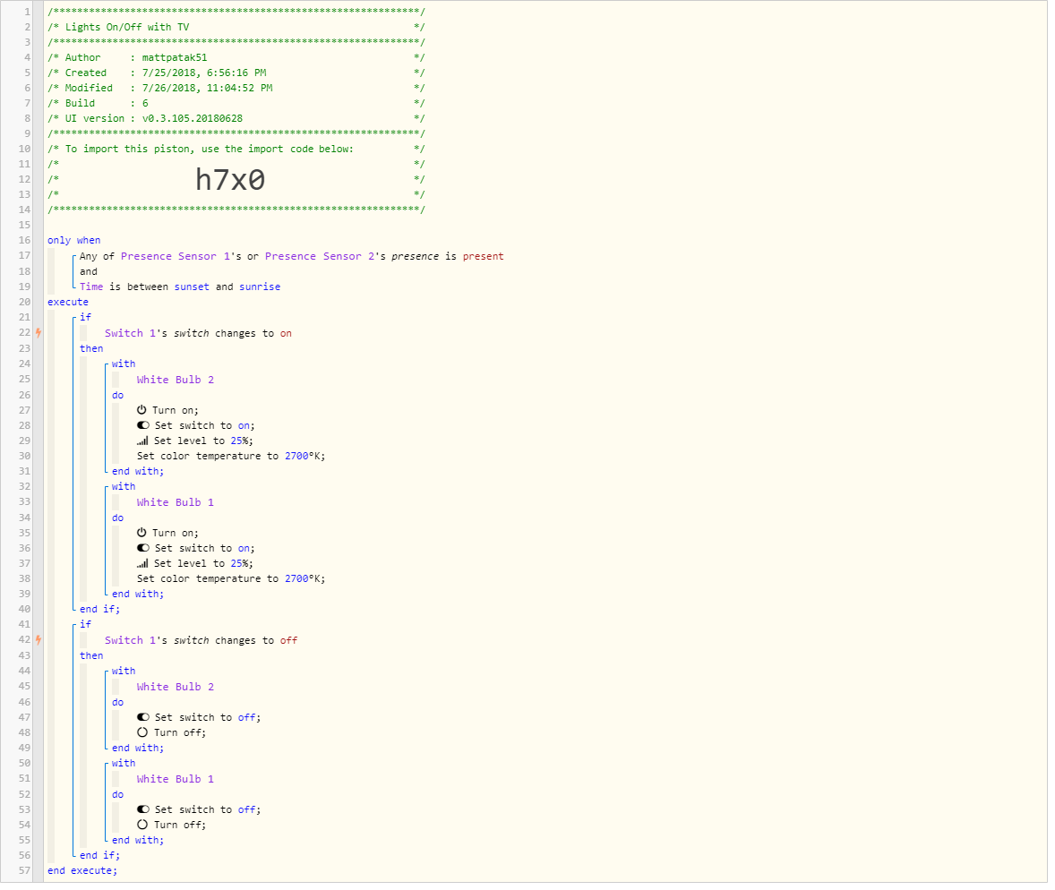

Lights fail to turn off or on when the TV is turned off or on.
I’m trying to get my lights to turn on and off with the TV, but only after sunset and before sunrise (when they’re needed)
When I power off the TV, the lights remain on. When the lights are off and I power on the TV, the lights remain off.

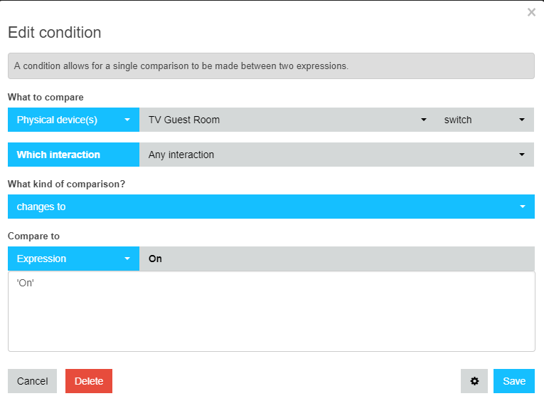

The problem is your TV is returning Off and On rather than off and on. Quick fix is to do this for your TV switch conditions to expressions and use the capitalized spelling:
That’s it! It works now, thanks michicago!
