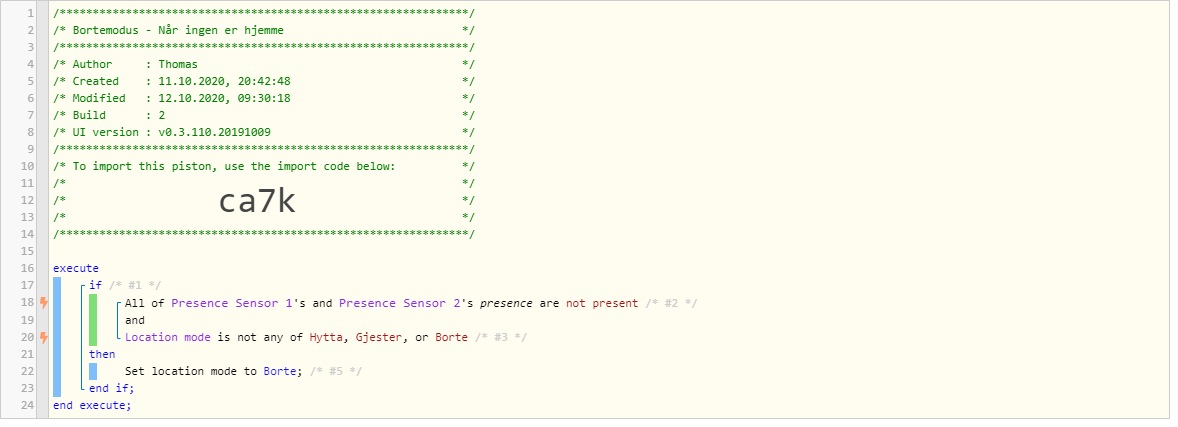

I have issues that pistons does not always run even though the conditions are met
For instans when all my precense devices are gone, change the location mode.
Nothing happens, but if i manually run “test” on the piston, what should happen, happens.
Your code looks OK. Perhaps post a Full log?
  • The piston should fire when either presence changes at all…
    (The piston also fires when Location mode changes to anything)
  • At which time, it checks to see if both sensors are “not present”
  • If that passes, then it checks your Location mode
  • If that also passes, then it runs the command on line 22.
    (which will restart the piston all over from the top)
