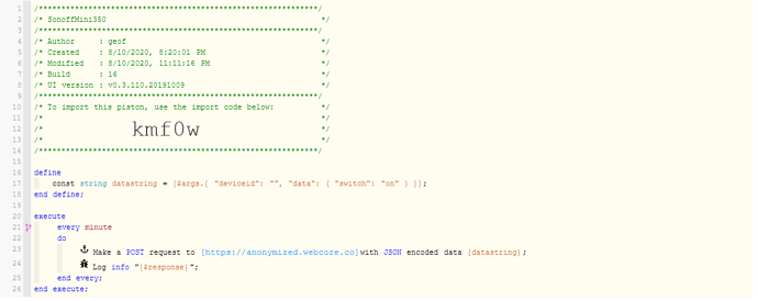

- Give a description of the problem**

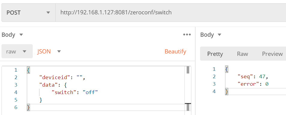

Sonoff Mini ver 3.5.0 has a new REST API protocol which allows local control directly. I have the device successfully switching with postman.
Reading the forums over the last few months, it seems that it always been the longterm aim of the Smartthings/Webcore community to control Sonoff devices directly without the need for firmware updates - perhaps we are a bit nearer?
I expect I have made a silly error - thanks in advance for any pointers
Should switch
Does not switch - but I see that the {“seq”:49, value increments so I must be close!!
this is the removed url:
http://192.168.1.127:8081/zeroconf/switch
8/10/2020, 11:15:16 PM +584ms
+0ms ╔Received event [PH].wc_async_reply = httpRequest with a delay of 1ms
+92ms ║RunTime Analysis CS > 16ms > PS > 36ms > PE > 39ms > CE
+94ms ║Runtime (37931 bytes) successfully initialized in 36ms (v0.3.110.20191009) (93ms)
+105ms ║║{“seq”:49,“error”:422}
+106ms ║║Executed virtual command log (1ms)
+109ms ║╚Execution stage complete. (15ms)
+110ms ║Setting up scheduled job for Mon, Aug 10 2020 @ 11:16:16 PM BST (in 60.084s)
+119ms ╚Event processed successfully (119ms)
