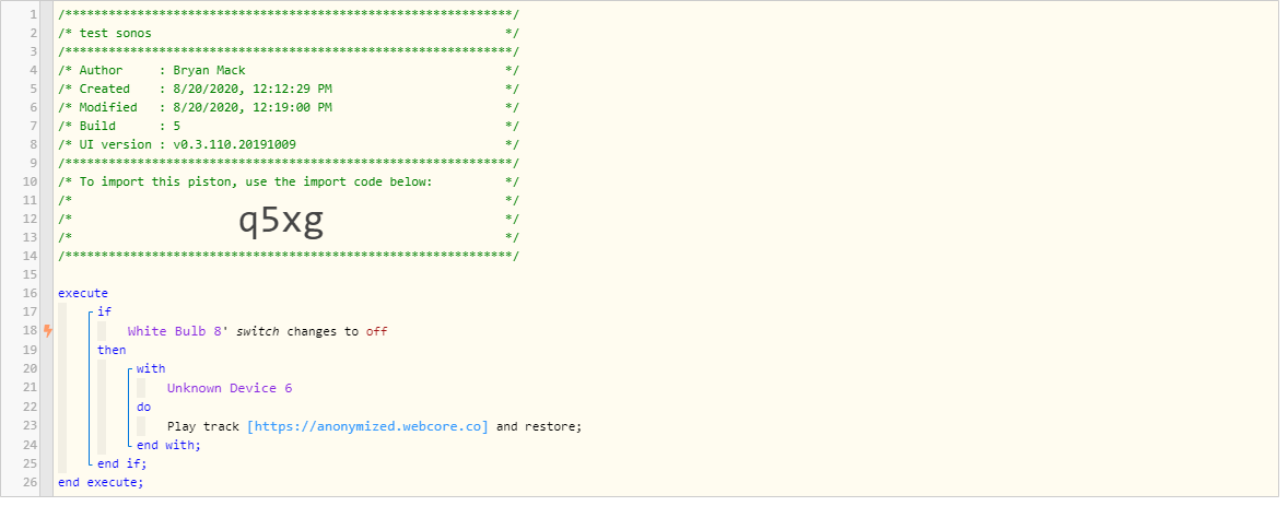

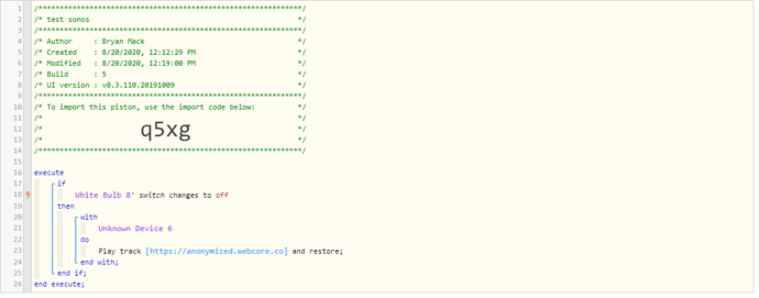

Since SmartThings put out a “new” connection to Sonos, “resume” and “restore” no longer work after playing a hosted MP3/alert
If I’m listening to music, it used to pause the music, announce the alert, then continue with the music. This is what I expected.
Pauses music. Plays alert. Then nothing happens.

+99ms ║║Executed physical command [Office Sonos].playTrackAndRestore([http://www.fleetmack.com/tts/welcomehome.mp3]) (9ms)
+100ms ║║Executed [Office Sonos].playTrackAndRestore (11ms)

+117ms ║║Executed physical command [Office Sonos].playTrackAndResume([http://www.fleetmack.com/tts/welcomehome.mp3]) (17ms)
+118ms ║║Executed [Office Sonos].playTrackAndResume (19ms)

+197ms ║║Executed physical command [Office Sonos].playTrackAndResume([http://www.fleetmack.com/tts/welcomehome.mp3]) (10ms)
+198ms ║║Executed [Office Sonos].playTrackAndResume (12ms)
