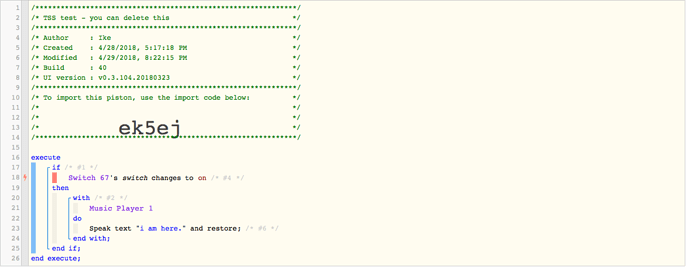

I have 4 Sonos one speakers. Text to speech was working 70% of the time:) But the other day it completely stopped working.
I saw in one of the posts that removing all sonos speakers and adding them back helped someone. tried that bu no success.
Tried:
Speak text
Speak text : resume
Speak text : restore
No success
Are there anyone using Sonos and TSS sucessfuly?
Just want to be able to use simple TTS for annoucements.
Play track with URL works without a problem. I can either play songs or mp3 messages. (pre-recorded mp3 messages not TTS)
| +104ms | ║RunTime Analysis CS > 14ms > PS > 16ms > PE > 73ms > CE |
| +106ms | ║Runtime (36463 bytes) successfully initialized in 16ms (v0.2.102.20180116) (104ms) |
| +107ms | ║╔Execution stage started |
| +115ms | ║║Comparison (enum) on changes_to (string) on = true (1ms) |
| +116ms | ║║Cancelling condition #4’s schedules… |
| +117ms | ║║Condition #4 evaluated true (5ms) |
| +118ms | ║║Cancelling condition #1’s schedules… |
| +119ms | ║║Condition group #1 evaluated true (state changed) (7ms) |
| +121ms | ║║Cancelling statement #2’s schedules… |
| +331ms | ║║Executed physical command [Sonos Entrance N].playTextAndRestore([i am here.]) (205ms) |
| +332ms | ║║Executed [Sonos Entrance N].playTextAndRestore (207ms) |
| +335ms | ║╚Execution stage complete. (228ms) |
| +336ms | ╚Event processed successfully (336ms) |
