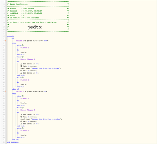

Hello,
More assistance please.
Why does it speak text twice?
Dimmer 1 is an IR toggle that mutes the television
Music Player 1 is a Sonos
Please attach some logs

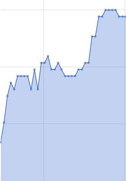

03/09/2017, 18:23:51 +13ms
+2ms ╔Received event [Lamp].power = 0.0 with a delay of 264ms
+5690ms ║RunTime Analysis CS > 18ms > PS > 5391ms > PE > 280ms > CE
+5697ms ║Piston waited at a semaphore for 5343ms
+5699ms ║Runtime (37838 bytes) successfully initialized in 5391ms (v0.2.0e6.20170830) (5697ms)
+5700ms ║╔Execution stage started
+5716ms ║║Comparison (decimal) 0.0 rises_above (integer) 500 = false (1ms)
+5718ms ║║Condition #4 evaluated false (9ms)
+5720ms ║║Condition group #1 evaluated false (state did not change) (11ms)
+5728ms ║║Comparison (decimal) 0.0 drops_below (integer) 99 = true (1ms)
+5730ms ║║Cancelling condition #12’s schedules…
+5731ms ║║Condition #12 evaluated true (10ms)
+5732ms ║║Cancelling condition #6’s schedules…
+5733ms ║║Condition group #6 evaluated true (state changed) (13ms)
+5737ms ║║Cancelling statement #15’s schedules…
+5890ms ║║Executed physical command [Mute].off() (145ms)
+5891ms ║║Executed virtual command [Mute].toggle (150ms)
+5895ms ║║Cancelling statement #10’s schedules…
+5957ms ║║Executed physical command [Family Room Sonos].setLevel([60]) (55ms)
+5958ms ║║Executed [Family Room Sonos].setLevel (56ms)
+5963ms ║║Executed virtual command [Family Room Sonos].wait (0ms)
+5964ms ║║Waiting for 2000ms
+8417ms ║║Executed physical command [Family Room Sonos].playText([James. The dryer has finished]) (447ms)
+8417ms ║║Executed [Family Room Sonos].playText (449ms)
+8422ms ║║Executed virtual command [Family Room Sonos].wait (1ms)
+8423ms ║║Requesting a wake up for Sun, Sep 3 2017 @ 6:24:02 PM BST (in 3.0s)
+8430ms ║╚Execution stage complete. (2731ms)
+8432ms ║Setting up scheduled job for Sun, Sep 3 2017 @ 6:24:02 PM BST (in 2.993s)
+8449ms ╚Event processed successfully (8449ms)
03/09/2017, 18:23:49 +845ms
+2ms ╔Received event [Lamp].power = -327.0 with a delay of 340ms
+309ms ║RunTime Analysis CS > 33ms > PS > 56ms > PE > 220ms > CE
+321ms ║Runtime (37767 bytes) successfully initialized in 56ms (v0.2.0e6.20170830) (318ms)
+323ms ║╔Execution stage started
+348ms ║║Comparison (decimal) -327.0 rises_above (integer) 500 = false (2ms)
+352ms ║║Condition #4 evaluated false (14ms)
+354ms ║║Condition group #1 evaluated false (state did not change) (18ms)
+369ms ║║Comparison (decimal) -327.0 drops_below (integer) 99 = true (2ms)
+371ms ║║Cancelling condition #12’s schedules…
+372ms ║║Condition #12 evaluated true (15ms)
+373ms ║║Cancelling condition #6’s schedules…
+374ms ║║Condition group #6 evaluated true (state changed) (18ms)
+379ms ║║Cancelling statement #15’s schedules…
+712ms ║║Executed physical command [Mute].off() (325ms)
+713ms ║║Executed virtual command [Mute].toggle (330ms)
+718ms ║║Cancelling statement #10’s schedules…
+768ms ║║Executed physical command [Family Room Sonos].setLevel([60]) (42ms)
+769ms ║║Executed [Family Room Sonos].setLevel (44ms)
+775ms ║║Executed virtual command [Family Room Sonos].wait (1ms)
+775ms ║║Waiting for 2000ms
+3217ms ║║Executed physical command [Family Room Sonos].playText([James. The dryer has finished]) (435ms)
+3218ms ║║Executed [Family Room Sonos].playText (437ms)
+3223ms ║║Executed virtual command [Family Room Sonos].wait (0ms)
+3224ms ║║Waiting for 3000ms
+6263ms ║║Executed physical command [Family Room Sonos].setLevel([25]) (33ms)
+6264ms ║║Executed [Family Room Sonos].setLevel (35ms)
+6269ms ║║Cancelling statement #19’s schedules…
+6316ms ║║Executed physical command [Mute].on() (40ms)
+6317ms ║║Executed virtual command [Mute].toggle (45ms)
+6323ms ║╚Execution stage complete. (6001ms)
+6333ms ╚Event processed successfully (6332ms)

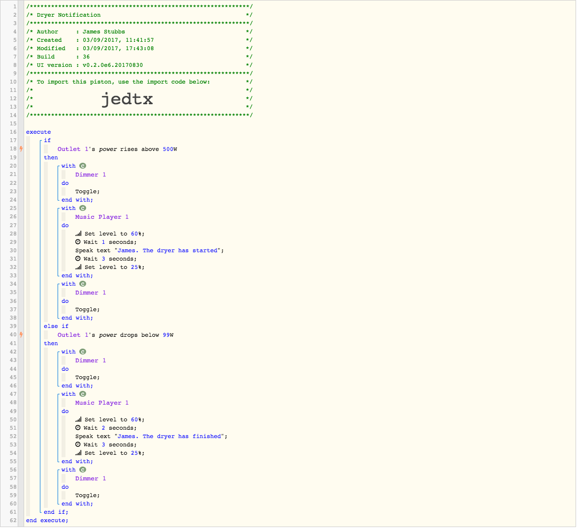

+7674ms ║║Comparison (decimal) 1644.4 rises_above (integer) 500 = false (1ms)
+7676ms ║║Cancelling condition #4’s schedules…
+7677ms ║║Condition #4 evaluated false (11ms)
+7678ms ║║Cancelling condition #1’s schedules…
+7679ms ║║Condition group #1 evaluated false (state changed) (14ms)
+7689ms ║║Comparison (decimal) 1644.4 drops_below (integer) 99 = false (1ms)
+7691ms ║║Condition #12 evaluated false (10ms)
+7692ms ║║Condition group #6 evaluated false (state did not change) (12ms)
+7696ms ║╚Execution stage complete. (39ms)
+7705ms ╚Event processed successfully (7706ms)
03/09/2017, 18:23:35 +47ms
+2ms ╔Received event [Lamp].power = 1647.5 with a delay of 259ms
+4031ms ║RunTime Analysis CS > 17ms > PS > 3841ms > PE > 172ms > CE
+4044ms ║Piston waited at a semaphore for 3794ms
+4047ms ║Runtime (37838 bytes) successfully initialized in 3841ms (v0.2.0e6.20170830) (4045ms)
+4048ms ║╔Execution stage started
+4065ms ║║Comparison (decimal) 1647.5 rises_above (integer) 500 = true (1ms)
+4067ms ║║Cancelling condition #4’s schedules…
+4068ms ║║Condition #4 evaluated true (10ms)
+4069ms ║║Cancelling condition #1’s schedules…
+4070ms ║║Condition group #1 evaluated true (state changed) (13ms)
+4073ms ║║Cancelling statement #13’s schedules…
+4125ms ║║Executed physical command [Mute].on() (44ms)
+4126ms ║║Executed virtual command [Mute].toggle (50ms)
+4130ms ║║Cancelling statement #2’s schedules…
+4177ms ║║Executed physical command [Family Room Sonos].setLevel([60]) (39ms)
+4177ms ║║Executed [Family Room Sonos].setLevel (40ms)
+4182ms ║║Executed virtual command [Family Room Sonos].wait (1ms)
+4185ms ║║Waiting for 1000ms
+5729ms ║║Executed physical command [Family Room Sonos].playText([James. The dryer has started]) (539ms)
+5730ms ║║Executed [Family Room Sonos].playText (541ms)
+5735ms ║║Executed virtual command [Family Room Sonos].wait (1ms)
+5737ms ║║Waiting for 3000ms
+8774ms ║║Executed physical command [Family Room Sonos].setLevel([25]) (32ms)
+8775ms ║║Executed [Family Room Sonos].setLevel (33ms)
+8779ms ║║Cancelling statement #17’s schedules…
+8824ms ║║Executed physical command [Mute].off() (39ms)
+8825ms ║║Executed virtual command [Mute].toggle (43ms)
+8828ms ║╚Execution stage complete. (4780ms)
+8838ms ╚Event processed successfully (8838ms)
03/09/2017, 18:23:33 +882ms
+1ms ╔Received event [Lamp].power = 1675.3 with a delay of 267ms
+231ms ║RunTime Analysis CS > 19ms > PS > 50ms > PE > 162ms > CE
+241ms ║Runtime (37764 bytes) successfully initialized in 50ms (v0.2.0e6.20170830) (239ms)
+242ms ║╔Execution stage started
+260ms ║║Comparison (decimal) 1675.3 rises_above (integer) 500 = true (2ms)
+263ms ║║Cancelling condition #4’s schedules…
+264ms ║║Condition #4 evaluated true (11ms)
+265ms ║║Cancelling condition #1’s schedules…
+266ms ║║Condition group #1 evaluated true (state changed) (14ms)
+270ms ║║Cancelling statement #13’s schedules…
+321ms ║║Executed physical command [Mute].on() (45ms)
+322ms ║║Executed virtual command [Mute].toggle (49ms)
+327ms ║║Cancelling statement #2’s schedules…
+374ms ║║Executed physical command [Family Room Sonos].setLevel([60]) (39ms)
+375ms ║║Executed [Family Room Sonos].setLevel (41ms)
+380ms ║║Executed virtual command [Family Room Sonos].wait (1ms)
+381ms ║║Waiting for 1000ms
+1785ms ║║Executed physical command [Family Room Sonos].playText([James. The dryer has started]) (395ms)
+1786ms ║║Executed [Family Room Sonos].playText (399ms)
+1795ms ║║Executed virtual command [Family Room Sonos].wait (1ms)
+1796ms ║║Waiting for 3000ms
+4836ms ║║Executed physical command [Family Room Sonos].setLevel([25]) (32ms)
+4837ms ║║Executed [Family Room Sonos].setLevel (34ms)
+4841ms ║║Cancelling statement #17’s schedules…
+4886ms ║║Executed physical command [Mute].off() (39ms)
+4886ms ║║Executed virtual command [Mute].toggle (43ms)
+4891ms ║╚Execution stage complete. (4648ms)
+4899ms ╚Event processed successfully (4899ms)
Any thoughts?
Best wishes.
I’m getting a similar result from a piston that I use to play a welcome home message. @Foggy Any updates? Ever get it working properly?
No I did not and didn’t get back to it.
Best wishes…
I haven’t started monitoring power usage yet, but from what I know about electricity, it fluxuates. I would venture to guess that your dryer actually went over 500W, then briefly dropped, then rose above 500W again. Something like this:
Maybe try tweaking 500W to another number? If that won’t work, you may have to use variables and/or duration checks.
