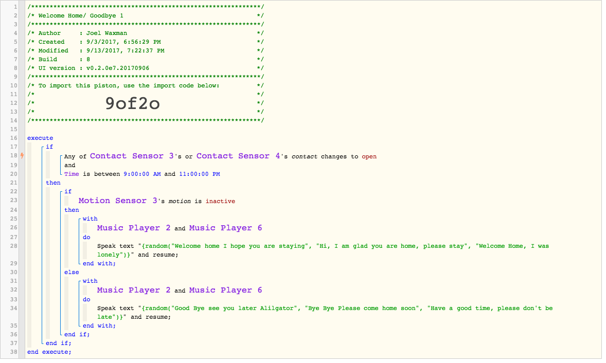

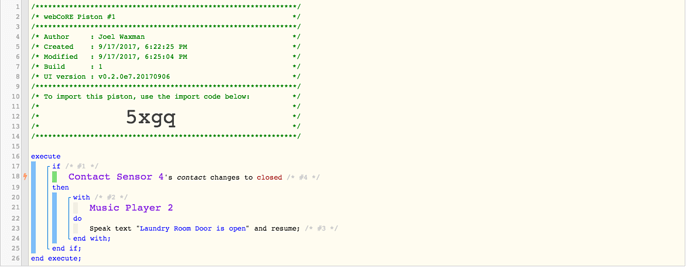

- I have a Piston below with two sets of speakers both work outside of WeBCoRE and one in WeBCoRE. The Samsung works in and out of WeBCoRE but the Fabriq doesn’t work with this Piston
- Both sets of Speakers should play when the conditions of the Piston are met.
- When conditions are met only the Samsung speaker announces the text.

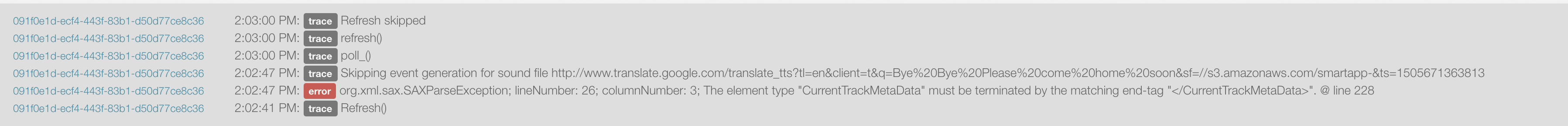

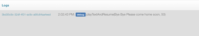

Here are the logs below. The Fabriq which works with all other automations such as Big Talker throws an error while the Samsung works.

What does the log in webcore throw? Does this also say google translate?
Did you try out the Fabriq alone in a simple piston with just some simple command?
Just trying to think debuging here.
Thats the log yes.

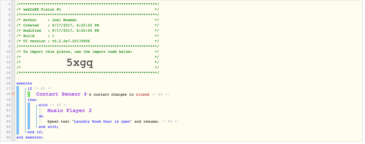

Wrote a piston, very simple one and it tested fine, but the Fabriq doesn’t speak Below is the piston.

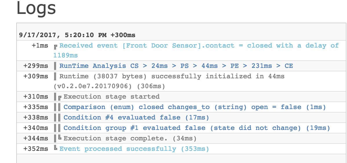

Ok then, both the log from IDE and WebCore full log for this.
And not at least, a confirm of what speaker app with text to speach that is working with this speaker.
Then there will be narroved log so ady can have a look at it when he got the time.

Have you tried setting a volume level? It sounds like Samsung handles the missing volume better than your other speaker. Always adjust the volume.
The volume is set to 50% for both speak commands. I had done that when I created the Piston.
