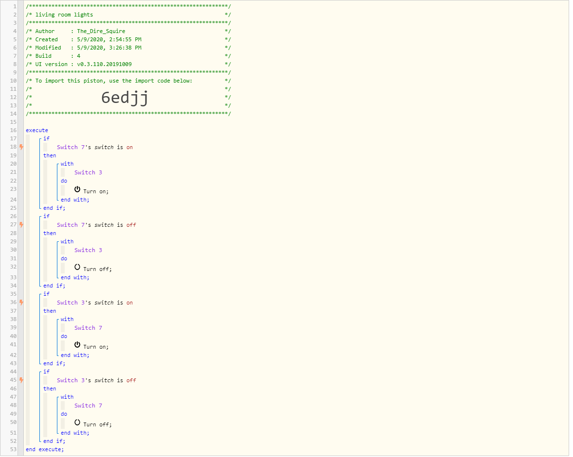

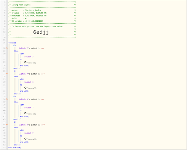

Here is the scenario i have 2 wall switches one is wired to a light the other is not, if the light switch is on/off the LED on the switch changes colour, i want to set these up as 2 way switching when one turns on the other turns on and vice versa, i have tried this with simple if statements but unsurprisingly this ends in a loop where they kept turning each other on/off, i assume i need to create some sort of timer in there to exit the self created loop i thought someone must have done this before…
act like standard 2 way switching
stuck in a loop

I think this will keep them in sync and avoid the loop by not doing anything if they are the same.
Thanks, guxdude worked like a charm I’ve been messing around with timers for a while now if one doesn’t equal the other is a much smarter idea! :slight_smile:
