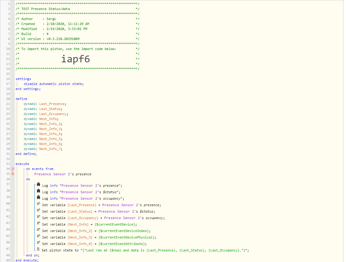

The $status attribute is a webCoRE invention. It gets the status of the device as in ACTIVE, INACTIVE, ONLINE, OFFLINE or HUB_DISCONNECTED. Although $status can be used in trigger condition, no event would ever be generated with that attribute.
I suspect you want to use the ‘presence’ attribute ‘present’ or ‘not present’). You could use the ‘occupancy’ attribute (‘occupied’ or ‘unoccupied’) but the secret of what that actually means for mobile presence doesn’t seem to have leaked out yet.

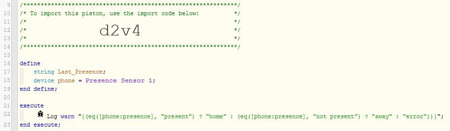

Been testing out the presence function in the new app using my G7 ThinQ. Pretty consistent and accurate results so far. Only gripe so far is that it just goes back and forth between “present” and “not present”. Would rather have seen “home” and away".

results
Nice analytical piston, @SergL… That is a great way to monitor the action behind the scenes!!
You can use an expression to do just that:
As seen here:
pic
More then likely inspired by one that I have seen of yours! :slight_smile:
Curious to see if ST will ever changes it once the new app is implemented to everyone across the board. Until then this is a great solution, thank you!
