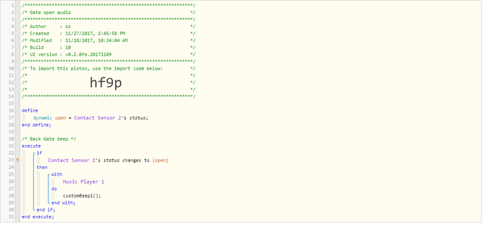

Is it a beep everytime the contact opens and closes?
If so, change the IF statement to contact sensor changes. Then everytime it opens or closes the piston will fire.
No need to save to a variable.

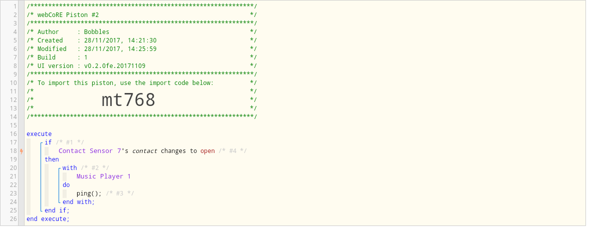

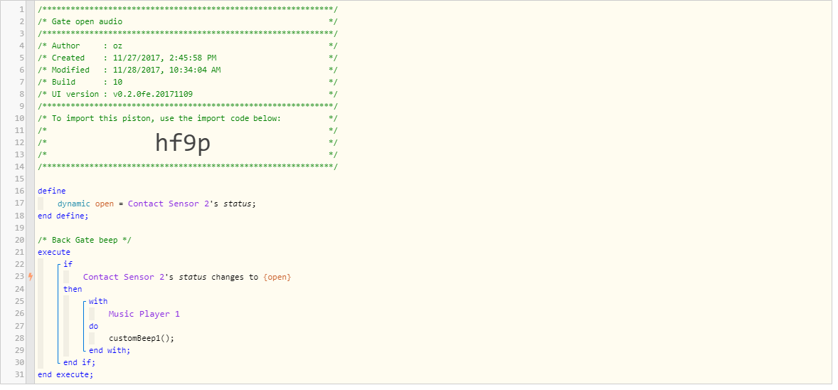

You can import this using the code and just change to use your devices.
Ignore the ping part as I cannot do custombeep with my player.

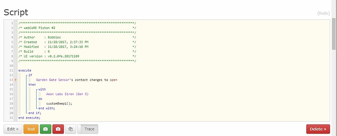

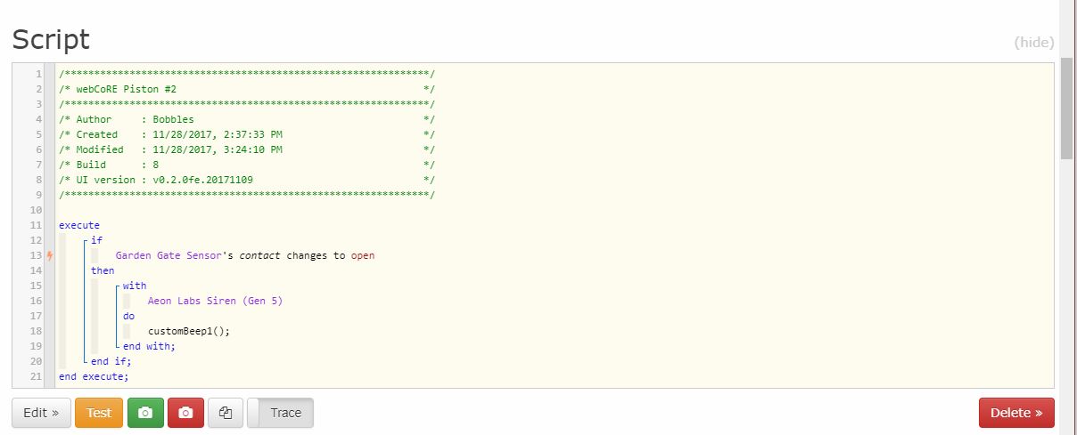

I did what you suggested. I saved and when I click test nothing happens. When I took a snapshot of the piston to post on here, the “music player” was showing in the snapshot not the Gate sensor which I replaced the music player with.
So when I save it it shows my Siren but when I save a screenshot your music player is back in the place where my siren should be.
The ping has gone and been replaced with my beep command. But still shows your music player.
I tried it 4 times and it still does the same.
The Snapshot facility anonamizes the piston to remove specific devices and puts in generic names to protect the users information.
If there is no sensative information in the piston just take a screenshot.
When you open the piston and click on the garden gate, you should get to a drop down with your devices. You then select your contact sensor. Is this not happening?
Yes it is, I then tick contact then tick changes to open then compare to tick value then tick open.
then in next part I choose my siren then do custom beep.

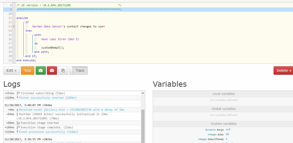

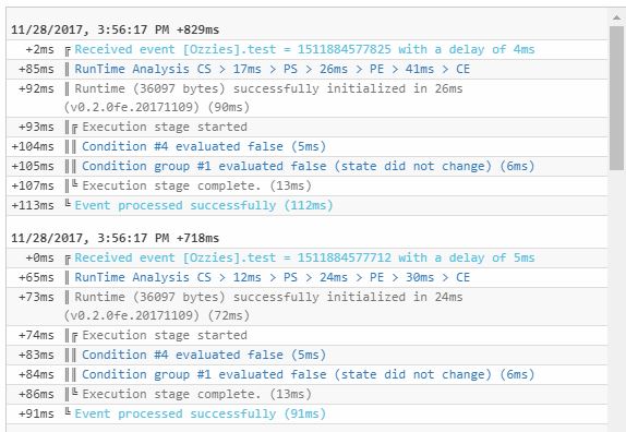

When I look at logging it says it’s working, but it’s not see attach
I tried a couple of different beeps which all work when I press them in the Android SmartThings app.
I just used the full logging and it shows false for a couple of things, do these matter/ see attached.
Test will not work as the trigger is changes to open. Hence the false you are seeing.
You need to open the gate to test it.
Alternatively change the trigger to something that you can do without opening the gate.
What people do is configure a virtual switch to use for testing. They then turn it off and on to trigger the piston.
Do you have motion sensors or a light switch you can turn on and off to test the piston. Just replace your contact sensor with something you can easily use for testing purposes then amend again with your contact sensor.
I think I need to appologise, I have been using the “TEST” button to see if it worked. Not actually doing the Piston., IE: I just opened the gate and it worked without problem.

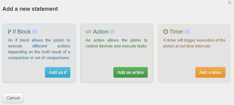

Another thing while I was trying different things today, when I first tried to do a new piston, an option box popped up like this
which never appeared before. I think this was why I was struggling, I had nowhere to start from so to speak. Anyway I think (touch wood) I can suss it now. For some reason I wasn’t getting the whole picture.

Should have mentioned in your settings when amending a piston to click on advanced statements. This opens up a lot more options for you.
