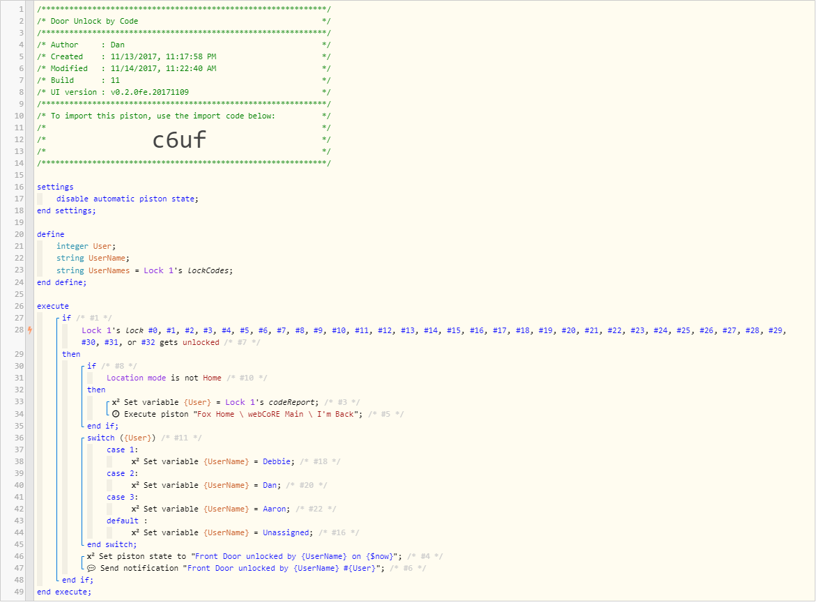

How to parse information that is reported, specifically which code opens the lock. Also, is there a way to pull the user name from lockCodes automatically?
If I unlock the door, codeReport seems to return a random number. In the log below, I used code 2, but the log reported code 3.

11/14/2017, 11:25:15 AM +309ms +1ms ╔Received event [Front Door Lock].lock = unlocked with a delay of 949ms +134ms ║RunTime Analysis CS > 18ms > PS > 86ms > PE > 31ms > CE +144ms ║Runtime (42200 bytes) successfully initialized in 86ms (v0.2.0fe.20171109) (142ms) +145ms ║╔Execution stage started +166ms ║║Comparison (enum) unlocked gets (string) unlocked = true (10ms) +168ms ║║Cancelling condition #7's schedules... +168ms ║║Condition #7 evaluated true (16ms) +170ms ║║Cancelling condition #1's schedules... +170ms ║║Condition group #1 evaluated true (state changed) (19ms) +177ms ║║Comparison (string) :467745ba74b17d0ba382451b50109027: is_not (string) :467745ba74b17d0ba382451b50109027: = false (2ms) +178ms ║║Condition #10 evaluated false (5ms) +179ms ║║Condition group #8 evaluated false (state did not change) (7ms) +182ms ║║Evaluating switch with values [[i:11:null:0, v:[t:integer, v:3, vt:string]]] +186ms ║║Comparison (integer) 3 is (integer) 1 = false (2ms) +190ms ║║Comparison (integer) 3 is (integer) 2 = false (2ms) +194ms ║║Comparison (integer) 3 is (integer) 3 = true (1ms) +196ms ║║Cancelling statement #21's schedules... +203ms ║║Executed virtual command setVariable (4ms) +206ms ║║Cancelling statement #2's schedules... +214ms ║║Calculating (string) Front Door unlocked by + (string) Aaron >> (string) Front Door unlocked by Aaron +217ms ║║Calculating (string) Front Door unlocked by Aaron + (string) on >> (string) Front Door unlocked by Aaron on +220ms ║║Calculating (string) Front Door unlocked by Aaron on + (string) Tue, Nov 14 2017 @ 11:25:15 AM EST >> (string) Front Door unlocked by Aaron on Tue, Nov 14 2017 @ 11:25:15 AM EST +223ms ║║Executed virtual command setState (1ms) +231ms ║║Calculating (string) Front Door unlocked by + (string) Aaron >> (string) Front Door unlocked by Aaron +234ms ║║Calculating (string) Front Door unlocked by Aaron + (string) # >> (string) Front Door unlocked by Aaron # +236ms ║║Calculating (string) Front Door unlocked by Aaron # + (string) 3 >> (string) Front Door unlocked by Aaron #3 +241ms ║║Executed virtual command sendNotification (3ms) +244ms ║╚Execution stage complete. (100ms) +252ms ╚Event processed successfully (252ms) 11/14/2017, 11:25:06 AM +963ms +1ms ╔Received event [Front Door Lock].lock = locked with a delay of 916ms +138ms ║RunTime Analysis CS > 38ms > PS > 72ms > PE > 28ms > CE +147ms ║Runtime (42198 bytes) successfully initialized in 72ms (v0.2.0fe.20171109) (145ms) +148ms ║╔Execution stage started +161ms ║║Comparison (enum) locked gets (string) unlocked = false (1ms) +163ms ║║Condition #7 evaluated false (7ms) +164ms ║║Condition group #1 evaluated false (state did not change) (8ms) +166ms ║╚Execution stage complete. (18ms) +173ms ╚Event processed successfully (173ms)

OK, I must be doing something wrong. I unlocked the door 3 times, once with each of my 3 user codes. All three times, codeReport returned 3, so that apparently is not the correct parameter.
The trigger in my pistion can recognize users, but I don’t see anywhere the value can be saved.
In row 33, aren’t you telling it to do exactly that - set the codereport to #3??
I figured out the problem. First a logic problem, I was setting the variable inside the “If Location mode is not Home”.
codeReport apparently doesn’t return the user slot. But usedCode does. See the attached, this works. It also returns #null if the door is manually unlocked. I need to clean up the code to eliminate that.
