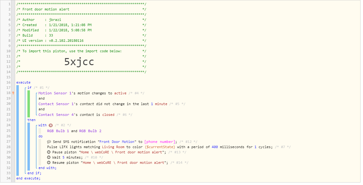

Stuck on Wait -- won't complete next task
Task following Wait does not happen.
Purpose of the piston: To send SMS message when motion sensor outside front door is tripped, unless I just opened that front door (to reduce false alarms if I just walked outside) or if my garage door is open (to reduce false alarms if I’m outside working in the lawn).
I would like this alert triggered only up to once per 5 minutes, so I added a Pause Piston, Wait 5 minutes and Resume Piston.
The Piston is not Resuming after 5 minute Wait. I have tried adding the “Never Cancel Task” to the with statement, but that has not helped. When I use Trace, the timer next to wait stays blue while it counts down from 5:00 minutes, then turns red while it just keeps counting up until I force the piston to resume.

A piston can’t resume itself… Once paused, it’s in lock down until you manually resume it or another piston resumes it.
remove the pause/remove and it should be good
Thank you all for the reply; however, once I remove pause and remove, the alert can go off as often as movement can trigger it. i.e. I keep waiving my hand over the sensor and I get near endless SMS alerts and lights flashing. Following the trace, the Wait 5:00 countdown just resets itself each time and seems to be doing now.
How can I limit the tasks to no more than once every 5 minutes?
On another note, why would the Resume Piston task be available if it is not functional?
A piston can resume a different piston, not itself.

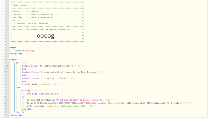

Try this one… If “Time” does not work, just change it to $now.
Make a variable called NextMessageAllowed or something. In the same block as your message, set it to addMinutes($now, 5).
In your top IF statement, add a condition that $now is after NextMessageAllowed.
