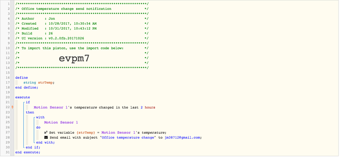

I am new to webCoRE and writing pistons and am more just trying to learn what is going on rather than having a specific problem that needs fixing with this. When I write an if condition like “Office M-sensor’s temperature changed in the last 2 hours” the logic in the then gets fired but if I reduce the time to 10 minutes the logic never gets fired. I can see the sensor device report back different temperatures every 59 minutes in ST web app (list events), so I am assuming for this condition there is nothing to compare against in the 10 minute range so my condition always evaluates to false. Correct?

When the temperature changes I want to get an email.
I get an email when the condition is “changed in the last 2 hours” I do not get any emails when the condition is “changed in the last 10 minutes”.
I can paste the logs if anyone wants but from the logs I see the subscription happen when I Save the script in webCoRE. By pressing Test or just waiting a few hours, I can see the piston fire and at 2 hours the condition evaluates to true and I see it send email but at 10 minutes the condition is always false and it never sends the email.
