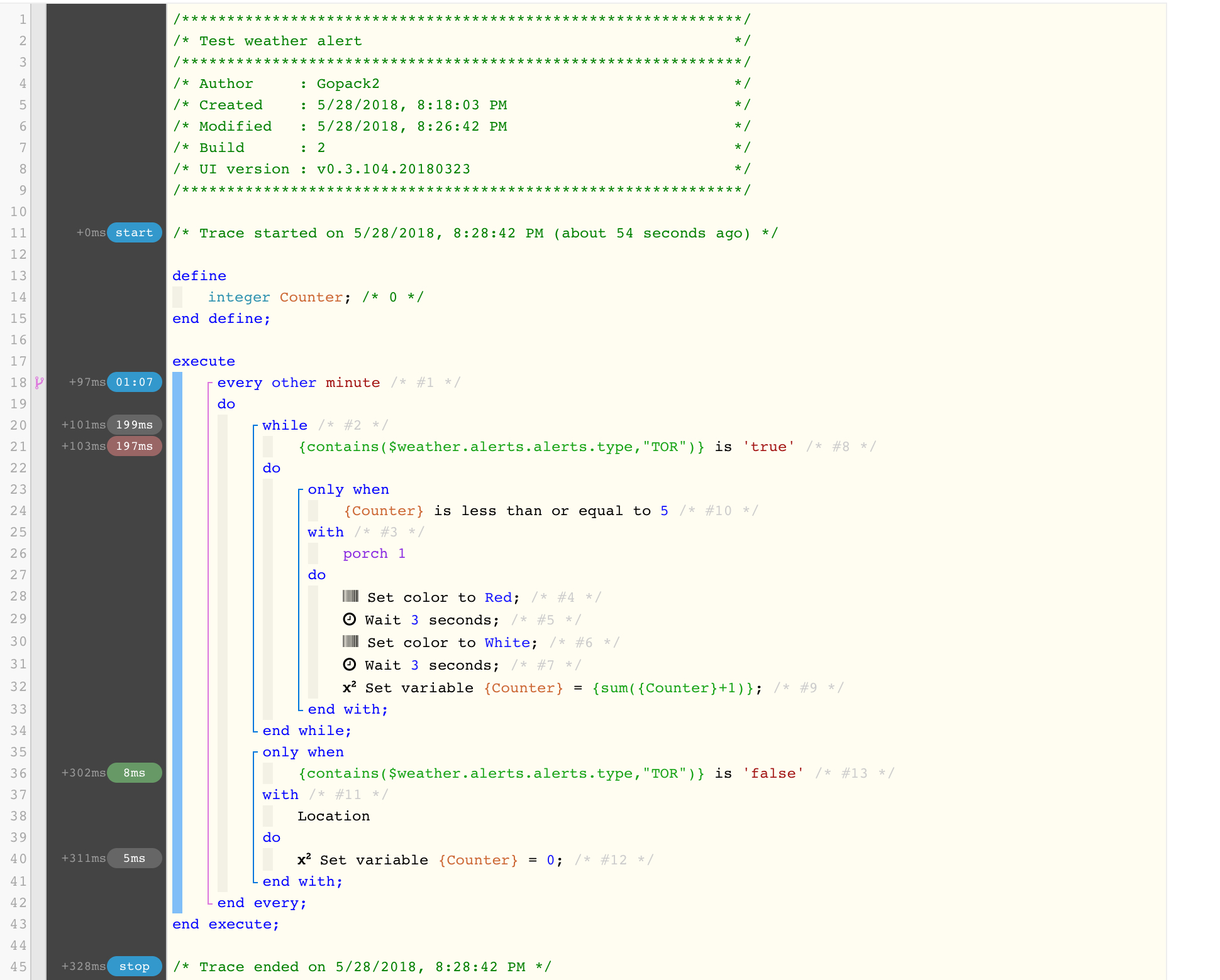

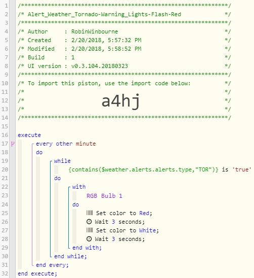

I think I originally got this piston from @Robin and it works great, but somehow, I forgot to program in something to make it stop, or to give it a limit, or some kind of interactive mechanism.
So, basically, I just need to figure that out, and add it to the code.
Anybody have ideas?
I suspect I should probably go back to a thread I recall somebody working on a while back where they listed out a whole bunch of ways of limiting a piston. I will look there when I get another free minute…
Runaway Automation (OK, maybe that’s a bit too dramatic, but…)
Perform the automation, but only until the user interacts somehow, or a period of time passes.
When there’s a tornado warning, it flashes my a particular light red and white (which is great), but then, even after I’ve noticed it happening, and I’ve been very well aware of the tornado warning now for a good fifteen minutes, the d@mn thing is still flashing lol .
