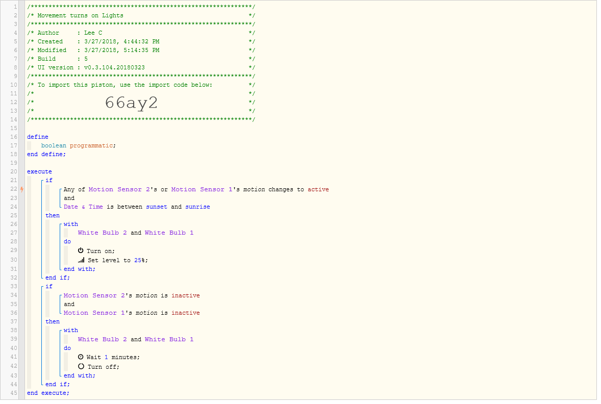

I have a simple (first) piston, which checks movement on 2 sensors (either) AND if between sunset & sunrise, turns on 2 lights.
Lights come on during the period between Sunset & Sunrise, but then do not trigger until the sunset for the day
Last night, no trigger before sunset as expected, then turned on after sunset - all fine. But this morning, the lights are still coming on well after sunrise (3 hours later)
