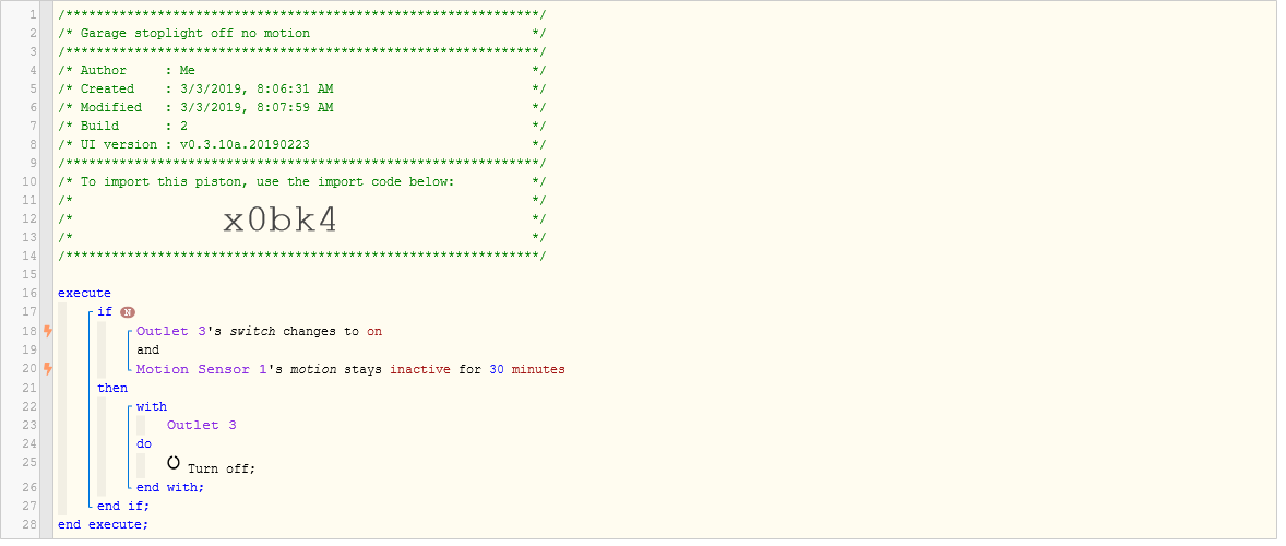

I have a simple piston setup for some lights in the garage. I want to turn them off XX minutes after motion stops.
Problem is the switch never turns off. I’m probably overlooking something pretty simple here.

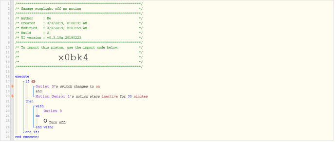

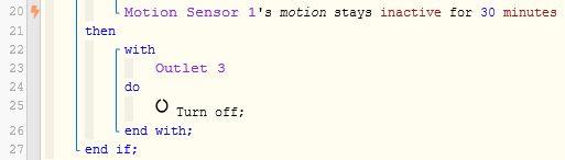

Yes,
What @Alwas recomended will work.
What you have is two triggers which will cause tons of problems.
Fo ryour piston to execute and turn OFF the outlet here is what needs happen (even then IF SO)
I believe what you want is (if i am not mistaken)
When outlet turns ON or IS ON, if there is no motion happening X minutes, you want outlet to turn OFF…
if I am correct, try this piston:
IF Motion sensor stays INACTIVE for 30 minutes
With Outlet 3
Turn OFF
That’s it.
I don’t know how you plan on turning it ON but if you want to turn it on with motion sensor then the new piston can be this:
IF motion sensor 1 motion CHANGES TO active
with outlet 3 turn ON
IF motion sensor 1 motion STAYS INACTIVE 30 minutes
With outlet 3 turn OFF
So I’m pretty sure I’ve had the first if set to if switch is on, and Motion sensor stays inactive and that wasn’t working either. But I don’t think the switch status had the lightning bolt off to the side. Does it need to subscribe to events? Or do I totally get rid of that if statement and only have the motion sensor.
These switches I will turn on manually. The whole idea of the piston is just to turn them back off if I forget.
If you turn them ON and forget,
the piston i recommended will turn them OFF in 30 minutes IF there is no motion in the room regardless of how they were turned ON
I agree with Ike. All you need is this:
IF
…and make sure that IF block’s “Task Cancellation Policy” is set to “On condition state”.
IE: remove the (N)
Perfect. I’ll give it a whirl. I suspect I was overly complicating it.
