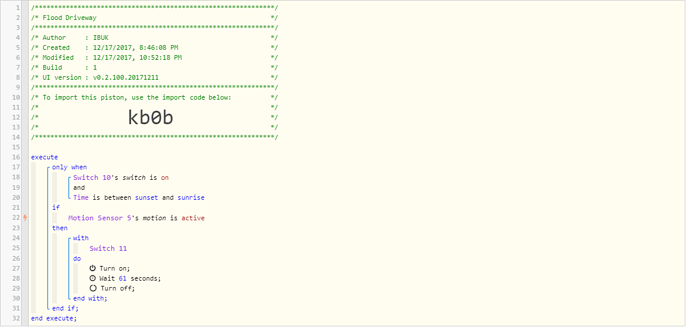

Whilst migrating my pistons over from CoRE I have a few that are identical (except different devices) and the structure has worked flawlessly in CoRE for months but fails to switch off in webCoRE. I’m struggling to understand why - I can get it working by adding another if for when motion changes to inactive but surely this is less efficient as it is subscribing to two events instead of one.
The switch should turn off 2 minutes after being turned on
In actual fact the wwitch doesn’t turn off at all as Line 29 does not seem to execute
Set Task Cancellation Policy (TCP) to never in your with.
You will find it when you click on the settings cog at the bottom of the page when you click on the WITH.

The problem with this is that when it changes to active the statement becomes true. As it needs to monitor the state as you are using changes to, after about 10 seconds the statement will change to false so the tasks will stop if you don’t change TCP to never.
