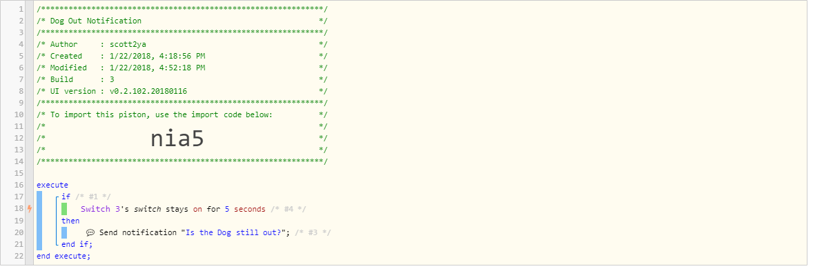

This seems like a super simple piston. But for the life of my I cannot figure it out.
Would someone be so kind as to help me out.
If my switch is left on for 30 minutes send push notification.
Thanks

Sorry guys, I figured it out… As soon as I am at my wits end, I finally saw the STAY condition and it all fell into place from there. Feeling stupid. But that’s the best way to learn.
Create and IF condition
IF (select your light, then “switch” from the next drop down menu)
Scroll down the conditions until you see “stays”, select “on” and set the duration to 30 minutes.
Add an action under THEN to push your message (leave device as location and then click add action, then scroll down to Send push message).
is there a trick to make push notification work? It’s a simple piston, but I get no notification. Do I need to allow it somewhere?
I just need to quit posting, lol… As soon as I post, I figure it out… “Push” notification not just notification… it’s working. Thanks!
Brainstorming out loud is a good way of pushing yourself to the answer… and replying with your own answer helps others… keep posting!
