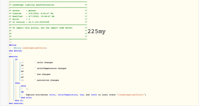

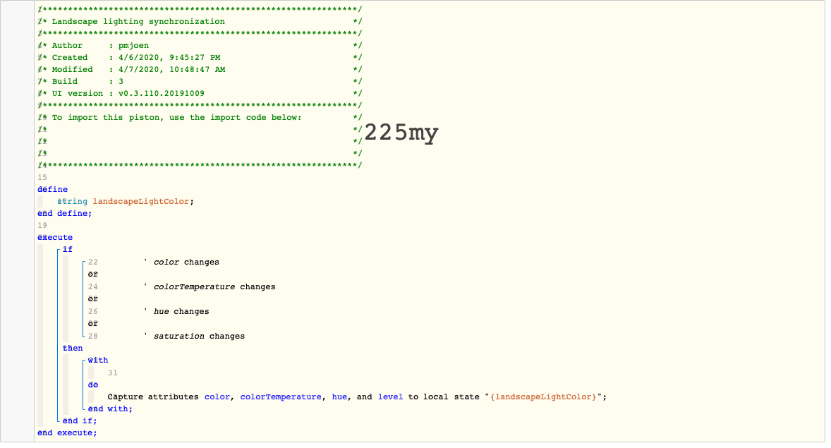

When the light color changes on a Sylvania LED strip I want to capture and change another Sylvania LED strip, but the variable is never captured
When the light color changes on a Sylvania LED strip I want to capture and change another Sylvania LED strip.

I capture and store the hue into an integer variable. I do the same with level and saturation.
For the record, many bulbs will have contradictions between color, colorTemp and HSL. I have found the best results when I only use one of them.
Here are a few examples from previous conversations.
