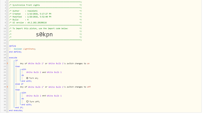

I’m trying to synchronize two switches. It works when I use one switch, but not the other.
When one is on, it turns the other one on. When one is turned off, the other is turned off.
If I use the one switch (Porch Light), everything works as expected. If I used the other switch (Garage Lights), the switch operates as if independent of the other switch. It appears that a trigger event is not being received by webCoRE when the Garage Lights switch is PHYSICALLY changed. If I change the Garage Lights switch from the app, it operates correctly. The logs show the switches being physically adjusted except during the 6:14 time. At that time, the garage lights were turned on and off with the ST app.

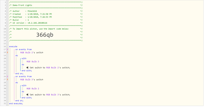

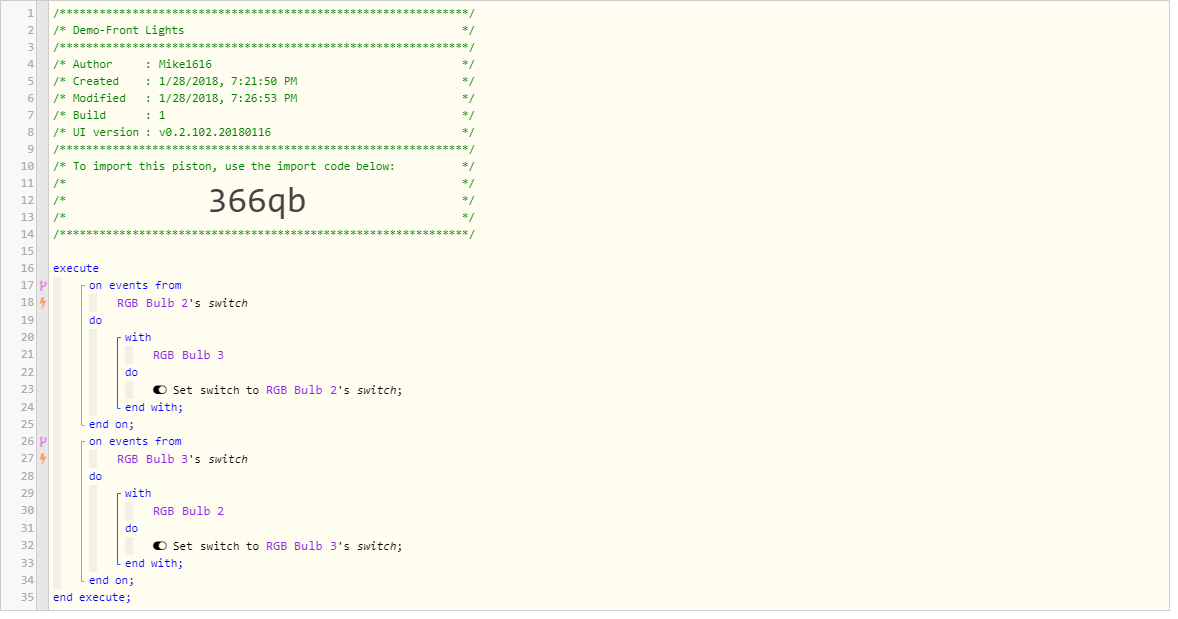

Yeah, I’m not sure about this one… There’s all sorts of possibility here for this piston to loop back into itself and that can often cause issues. I actually do something similar to what you’ve got going here but I use the Smart Lighting app rather than a WC piston. However, if you want to continue down the WC path then maybe give what I’m showing below a try.
It’s a cleaner way…and saves you some code. However, if this does not work then I think you’ll need to figure out why your one switch is not sending events when it gets turned on physically. With this piston you could comment out one of them and then just try it against the one you’ve been having issues with. That way you can see if there’s a problem just getting the switch to send events. If the switch does not do that…then there’s nothing a WC piston is going to do to fix that.
Thank you so much for the quick reply! I just imported your code and got the same results. I’m questioning if there is an issue with the switch at this point. I’m going to reach out to the manufacturer and see if they have any suggestions. Thanks again!
