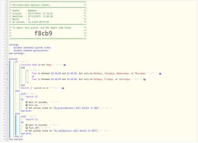

I have a piston as shown below.
As you can see, the off command is sent at different times during the week and at weekends.
In the recently tab I can see that during the week the off command is being sent at 22:45 and 23:00.
This is not causing an issue but I believe that this shouldn’t be happening.
Any ideas?
EDIT:I have command optimisation on but surely this is not the problem. Will have to give it a try.
Task being sent when it shouldn't be
All four conditions are subscribed so any one of them will fire the piston…
Toggling switch 2, changing the mode and the start / end of your time windows will all cause the piston to run and in most cases the else part will be selected.
Chose what you want to be the trigger and unsubscribe the rest.
As soon as I read your reply it made so much sense. I hadn’t thought this one through had I.
I changed them all to auto subscribe and that will work.
As for the logs, logging wasn’t turned on, I got the info from the recently tab when I looked to see why the light turned on for no reason. There was no ON command but there was an OFF command.
Thanks again for the pointer (as obvious as it seems now) I would have continued to scratch around with it.
