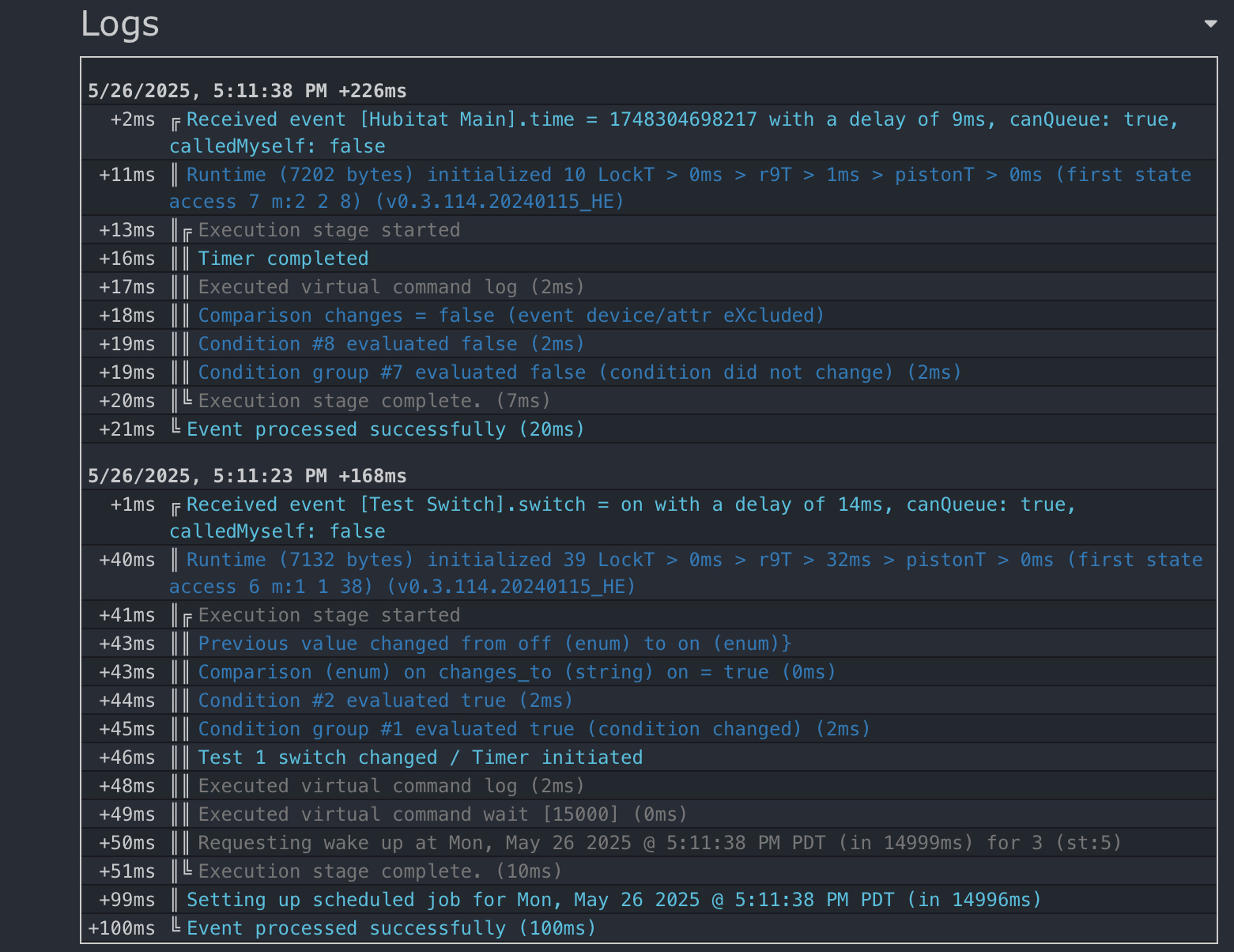

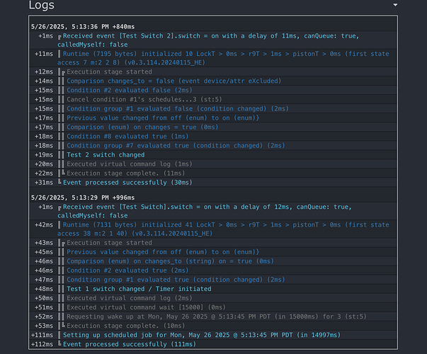

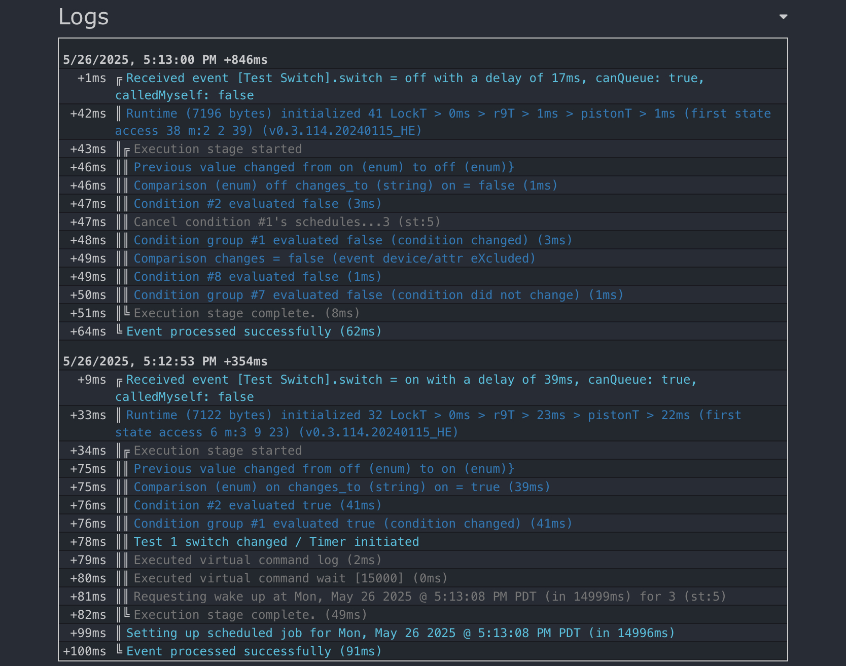

Wait scheduled action get canceled when a different trigger than the one that initiated it changes
Wait scheduled action only get canceled when the trigger that initiated changes

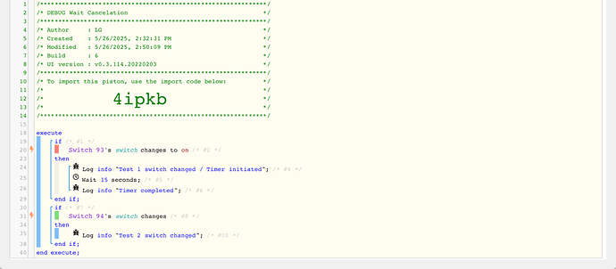

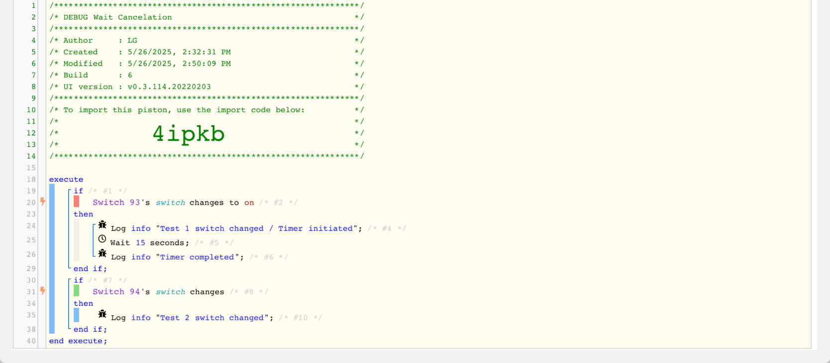

See above. I can update TCP to never cancelled but the wait scheduled task never get canceled even when the trigger that initiate it changes.
Expected behavior when Test Switch triggers and doesn’t changes:
Expected behavior when Test Switch triggers then change (scheduled wait run get canceled):
Unexpected behavior when Test Switch 2 triggers (scheduled wait run get canceled):
My understanding, which may be wrong, is that waking up a piston cancels any outstanding tasks, not just the tasks related to the event which triggered the piston.
