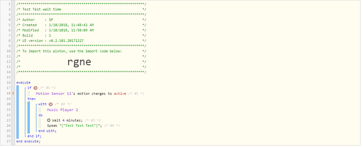

Task Cancellation Logic
Even though task cancellation policy is set to never cancel task, task is still cancelled.
I want it to wait for 4 mins and then send a command to speaker (even though motion has stopped)
Once motion is inactive, task gets cancelled.
(UPLOAD YOUR IMAGE HERE)
There is no way to help without supplying full logs. I’m sorry.
What happens if you get rid of the never in the WITH.
It’s not doing anything.
This was only half part of the piston hence did not post the logs. Will post the logs tonight.
Also will try to get rid of never in the with and see if it makes any difference.
Piston:
Logs
1/10/2018, 9:58:24 PM +248ms
+1ms â•”Received event [LRoom Motion Sensor L].motion = inactive with a delay of 197ms
+141ms â•‘RunTime Analysis CS > 36ms > PS > 35ms > PE > 69ms > CE
+143ms â•‘Runtime (36836 bytes) successfully initialized in 35ms (v0.2.101.20171227) (141ms)
+144ms â•‘â•”Execution stage started
+151ms â•‘â•‘Comparison (enum) inactive changes_to (string) active = false (1ms)
+152ms ║║Cancelling condition #5’s schedules…
+153ms â•‘â•‘Condition #5 evaluated false (5ms)
+154ms ║║Cancelling condition #1’s schedules…
+154ms â•‘â•‘Condition group #1 evaluated false (state changed) (6ms)
+157ms ║╚Execution stage complete. (14ms)
+158ms â•‘Setting up scheduled job for Wed, Jan 10 2018 @ 10:01:21 PM CST (in 177.088s)
+170ms ╚Event processed successfully (170ms)

Get rid of the never against the IF.
According to the logs the command was issued several times to speak.
Instead of speak text try using speak text and restore or speak text and resume
You are correct. I decreased the wait time and I did hear the command from speaker. I think I was making a dumb mistake. I was only clicking on Test and waiting to see if the timer starts. Timer use to start but once motion was inactive, timer use to stop on the trace. So I used to assume that it is not working and change/update the piston. Need to be more patient with these things :slight_smile:
