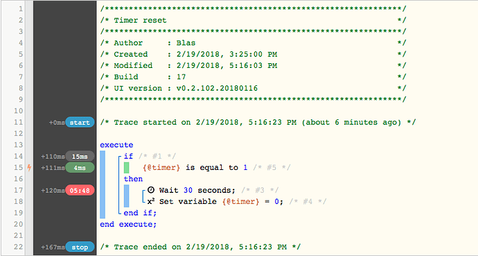

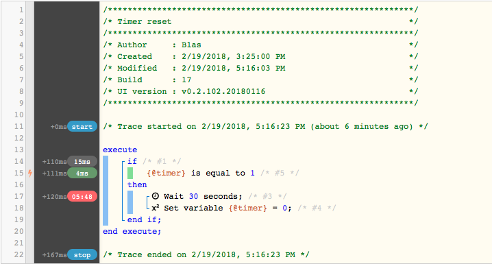

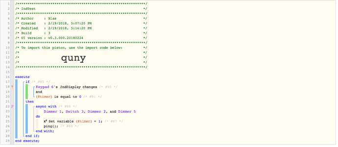

I need to reset a variable every time it changes but giving it a 30 second wait
The variable resetting
The timer is getting stuck

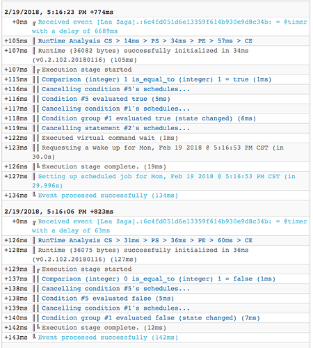

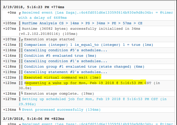

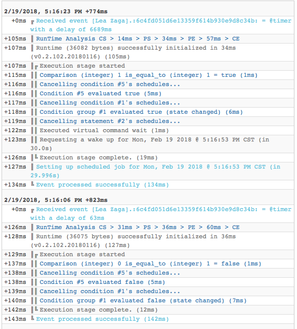

So that’s the full logs?
It never comes back from the Wait?
Odd. You could try shrinking the wait time in order to test out the logic. Waits can sometimes cause issues with pistons if there is a change to the initial condition which triggered the piston.
You could also try adjusting the Task Cancellation Policy to make it Never. That’s a guess though.
Tried even with 5 seconds and still have the same issue. Also tried the TCP to never. No solution yet

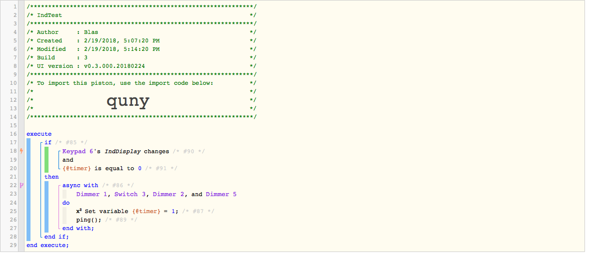

Can you post a green snapshot of the piston driving your @timer variable?
Sorry for the delay
