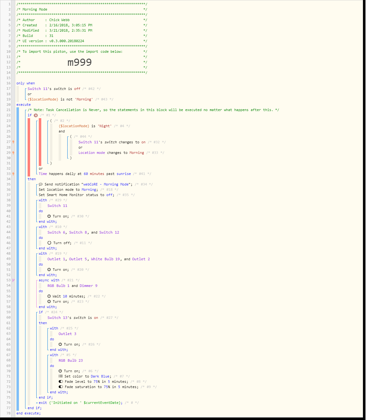

I’m trying to create a piston to change the mode of the house and do a bunch of things if any of three things happen - a switch is turned on, the mode is changed, or the time becomes a certain time of day. Morning mode, for example, which can be triggered by turning on the Morning Mode switch, or by a Routine that changes the mode to Morning, or at 60 minutes after sunrise.
If the house isn’t currently in the desired mode, then if the mode’s switch is turned on, or SmartThings mode changes to that mode, or the time reaches a threshold, then run all of the tasks (some of which include waits). If the house is already in that mode and the switch changes or the time is reached, or the switch is already on and the mode changes or the time is reached, or the timer is reached and the mode is already correct and the switch is on, then do nothing. Tasks scheduled by the piston should always complete once they’ve been scheduled.
Since the piston can be triggered in multiple ways, some of the actions change the triggers to the “correct” values for that mode. So, if you use the switch to change the mode, one of the actions will set the mode. Since setting the mode is a trigger, this will trigger the piston again. The piston should not do anything if it reenters in this way.
I’ve set the main “if” to TCP=Never, but tasks that have been scheduled by the first run-through (when the switch was turned on), are cancelled when the piston triggers again (even though the restrictions prevent it from running) because the mode changed in the first run-through. That is unexpected. Perhaps I have an incorrect understanding of “Never”? What I’m looking for is an answer to why, specifically, that 10 minute wait (#22), is getting cancelled. Thanks in advance, all.

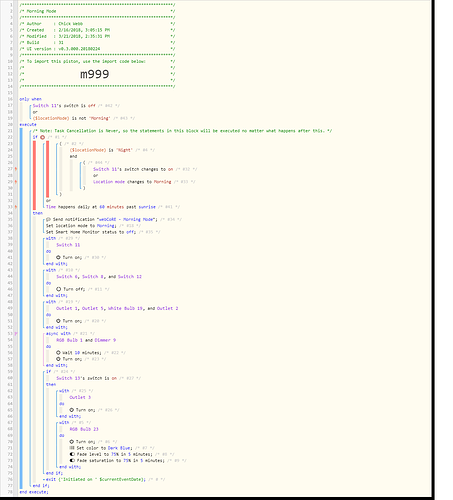

A couple of thoughts:
  • You have the Never TCP in the wrong place. It needs to be on the statement(s) that you don’t want to get canceled when the condition of the if statement it/they is/are in changes. So in this particular case, you need it on (at least) the async with statement (#21.)
  • You also have to consider the TSP (Task Scheduling Policy.) This one controls what happens when the statement is attempted to be run again, and it’s still running. The default is Override, which basically means it will start over. If you don’t want that then you need to change TSP to Allow Multiple. But in this case, know that there will potentially be multiple executions of the statement happening concurrently, shifted in time.
Thanks. Yeah, I decided to move those TCP Never directives to the individual statements and that seems to have done it. Since it was an available setting, I thought that if you put it on an entire block as I did, it would apply to the entire block. Doesn’t seem to be the case, though. Good to know.
I’ll have to look through the logs and see if there’s any need for TSP to be changed. Thanks for the heads-up.
