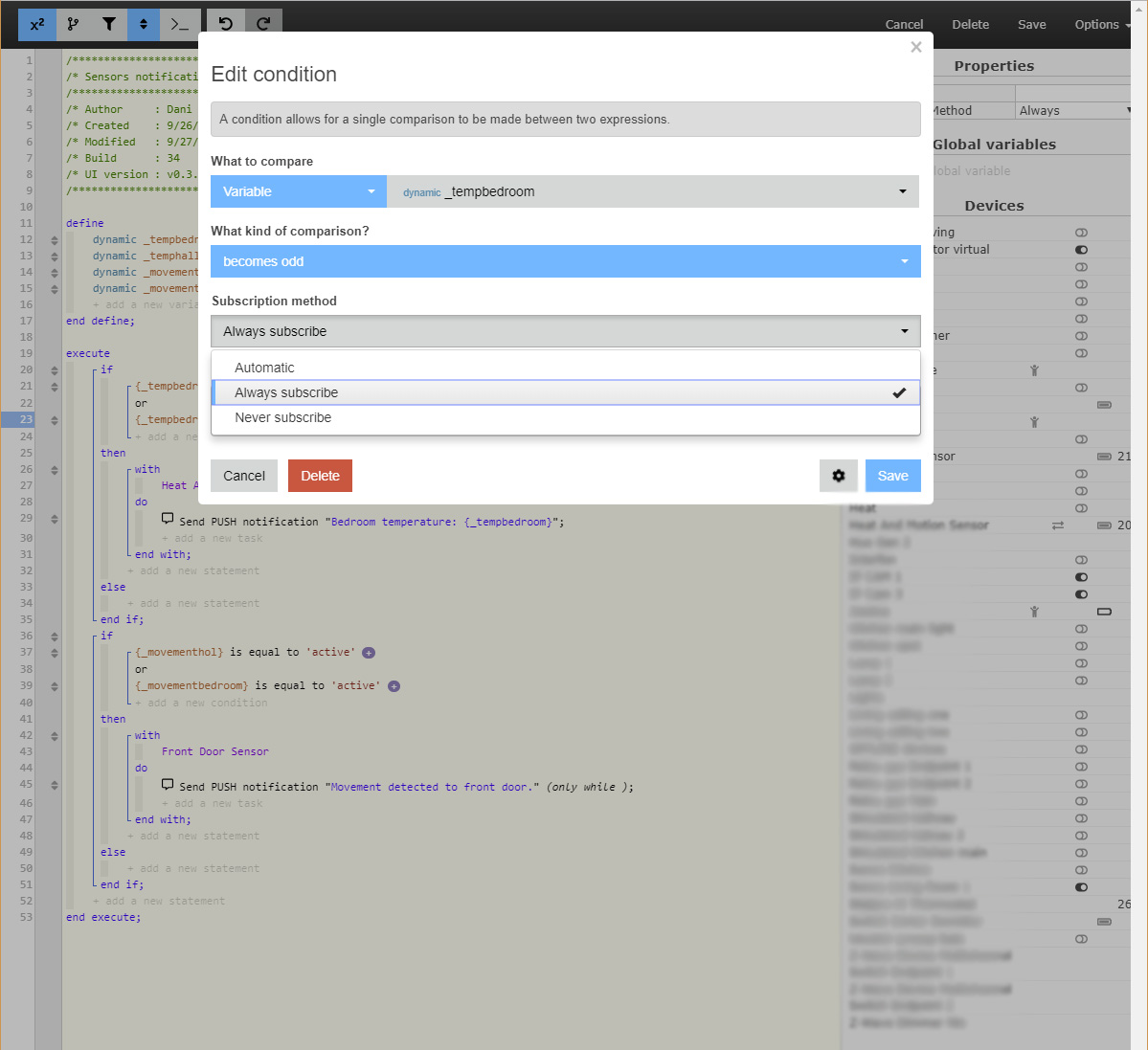

Force the subscription to the variables, click the condition and then the cog icon, change the subscription from Auto to Always.

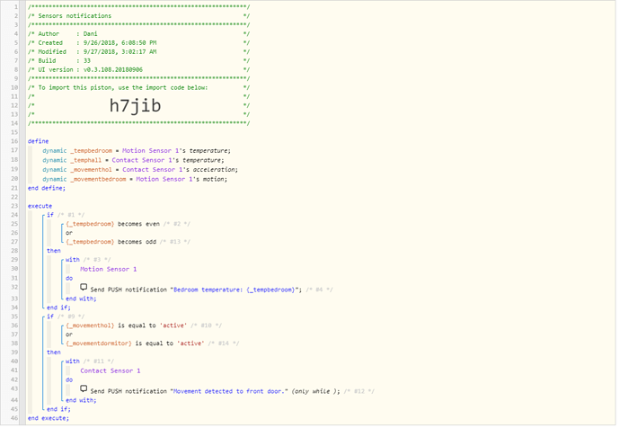

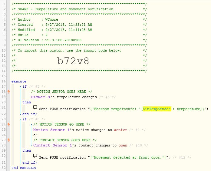

Here is how I would create the piston:
I added a few comments in green so you can verify the right devices are in the right section. The only other edit you will need to do is the highlighted section. It should be typed out the exact name of your Motion Sensor in place of SimTempSensor.

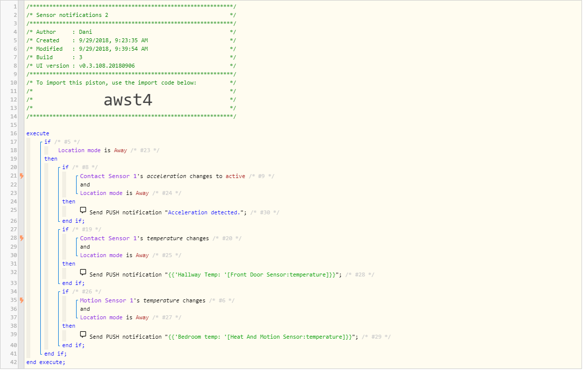

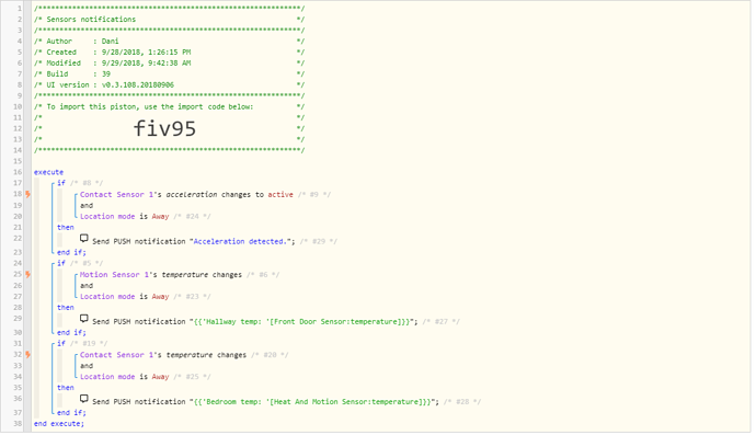

Hello again. Based on your scripts I’ve made a first script that it is working and another optimized script less lines that is not working. I want to understand why the second “Sensor notification 2” script bellow do not trigger.
This is the script that works:
And this is the script that do not trigger when the first condition is pleased:
Does anyone know why the second script do not trigger?
Thank you.
An IF inside another IF can be tricky…
I like my top level (far left) IFs to be a precise moment in time… (the trigger)
The things that are true for hours at a time, (ie: Location is Away) I usually place inside (or below) the trigger, and treat as conditions.
So the first script can not be optimize more than it is?
(this is what I tried with the second script…)
Well, that is a loaded question, LOL
Even months after I create a piston, I often go back inside to tweak my code a bit… But it looks very streamlined in your top picture right now, yes.
(although I suspect you will quickly get tired of all the notifications)
