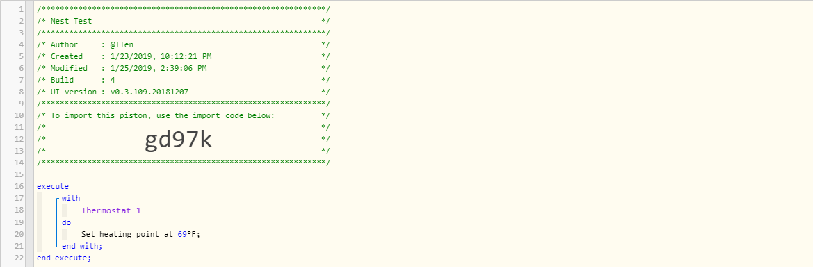

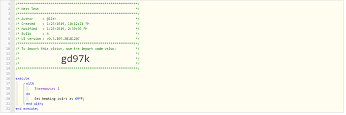

I’m using a simple action just to test before I try to build IF statements, but it won’t change the temperature. The mode is on heat & cool due to the weather being up and down. I have a 1st generation nest and using the device handler by tonesto7 in ST.
Change the temperature to what is defined for both heating and cooling
Tempature is not changing to what is defined in webcore
**4)
**5) 1/25/2019, 2:41:08 PM +483ms
+1ms ╔Received event [Home].test = 1548448868482 with a delay of 1ms
+126ms ║RunTime Analysis CS > 23ms > PS > 82ms > PE > 20ms > CE
+129ms ║Runtime (36229 bytes) successfully initialized in 82ms (v0.3.109.20181207) (126ms)
+137ms ║║Cancelling statement #1’s schedules…
+421ms ║║Executed physical command [null].setHeatingSetpoint([69.0]) (274ms)
+423ms ║║Executed [Nest Downstairs].setHeatingSetpoint (276ms)
+428ms ║╚Execution stage complete. (297ms)
+429ms ╚Event processed successfully (429ms)
